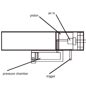

My prototype
Ok, a few things happend tonight. I spoke to my dad freind who is a machinist and he say my design might not seal at high pressures, also told me machining is expensive. I wish I had the tools to do it myself.
I gave the prototype to my freind to examine (and to scare his cats, it ain't powerfull rightnow). I still believe in the design and I have a different one for a clip fed pistol that is foolproof
But anyway, I will share the design, I made a GIF animation earlyer which I will post up. Self expanitory really.

- launcher.gif (17.86 KiB) Viewed 1244 times

is that just a hose barb where the air comes in, leading to a solid piston with a hole to to through to the air chamber? then to fire it you move the tigger back?
If it is thats a very good design, something similar i would do is maybe a bigger chamber, and change the nipple to a tyre vavle so you dont need constant flow.
Also is there a sealing face on the bottom part of the piston, to seal against linking to the chamber?
EDIT: Whoops, just realised the o-ring on either side of it. THis design is very good

You're essentially making an oversized slide valve.
If you can get everything machined to sufficient tolerances and get the o-rings to slide and seal as they should then it should be nice to see.

I found this one wikipedia about o-rings.
"They can seal tens of megapascals (thousands of psi) pressure."
I really don't see why it wouldn't seal if you construct it correctly.
I really like the design. Good job thinking up something new. It's basically a modified chamber sealer. If you're making it for paintball use, how will it be loaded?

Ok, but I don't know where I could get it made. Maybe sometime this year. I am not listening to what my freinds dad said, sure a lot of it was good but I beilieve this will work. He suggested a cup seal design but that would over complicate things.Hotwired wrote:If you can get everything machined to sufficient tolerances and get the o-rings to slide and seal as they should then it should be nice to see.
I would like to make a break barrel loader, so you pop the barrel out the side (pivoting at the front) of the launcher for easy quick loading.keep_it_real wrote:I really like the design. Good job thinking up something new. It's basically a modified chamber sealer. If you're making it for paintball use, how will it be loaded?
