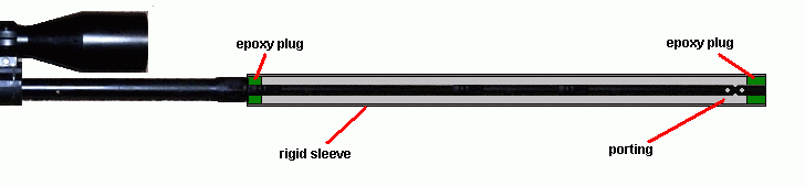

If I could make a suggestion, why not sleeve the barrel with a rigid piece of pipe (possibly even the same material as the chamber) and port the ends, this will give you a sturdy barrel along with an integral suppressor, with the added benefit of reduced muzzle blast so there's less air to destabilise the projectile as it exits the barrel.
It would also look better aesthetically, more "realistic" so to speak

I like the idea, I have thought about it before. I didnt want to because I wanted to call the stock done, but I am thinking I will do just that.
