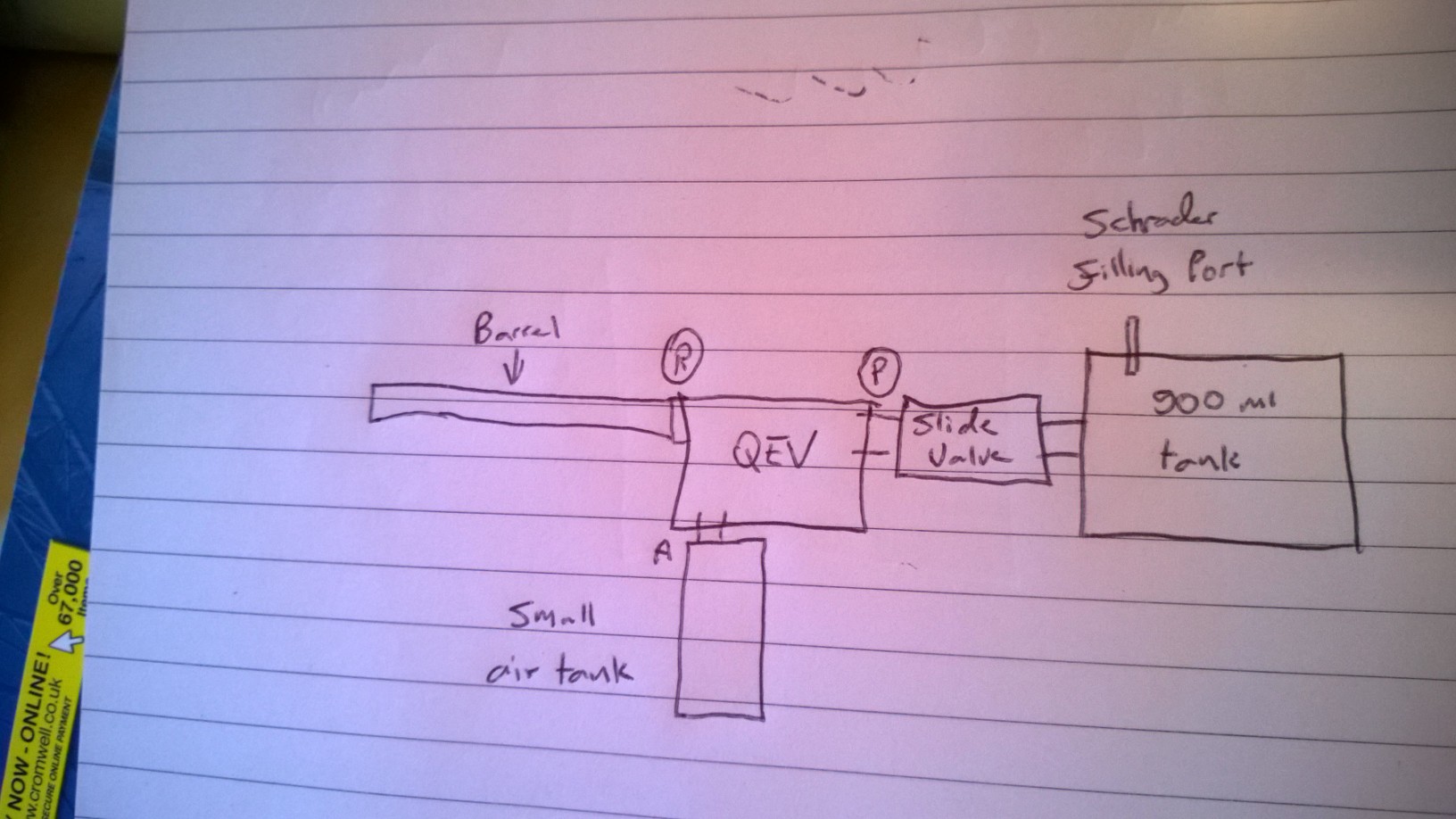

Hope this picture upload works...
Looks as though I cant upload pictures with my Nokia Lumia 920 windows phone
. I can email diagram if anyone wants to look it over if anyone is willing to PM their email address
Basicaly i have the qev, a barrel on the R port, a small (to be calculated size) tank connected to port A of the qev, port P of the qev has the slide valve which then attaches to the ~900ml tank.
Does that sound about right?

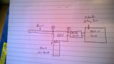

Had to email file to nexus, then download, bit long winded but it should work :)

Thu May 01, 2014 10:02 pm
I Forgot to add a pressure guage, it wont nwcessarily be placed like the drawing, but do the layout of connections seem right? I ordered 15mm od diameter thick wall steel tubing for the barrel, the internal diameter is 9mm so it has 3mm wall thickness, maybe a bit ott for what I am making but it brings the barrel down to a nice size to use with steel slingshot bearings
I also hope there is less chance it will be damaged or bent during delivery.
Sat May 03, 2014 5:04 am
Your design looks good.
One think about slingshot bearings, they are usually 3/8" diameter which is 9.52mm, they might be a tiny bit too large for your chosen barrel depending on the tolerance.
A gauge on both your main chamber and firing chamber will help you determine how much air you lose after each shot, and therefore the consistency of each shot.
