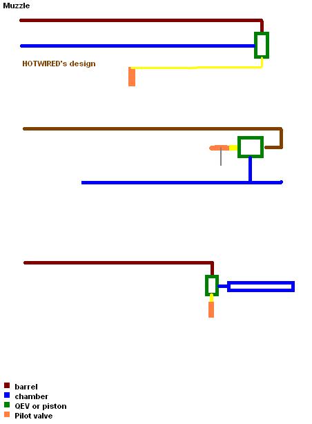

Ok, so as the title says, I will be building an over-under gun of about marble caliber. So far what I've got is a 1/8" qev shuttle for actuation, a blowgun to actuate that, and a 14" 1 1/2" steel chamber that I was going to use for my airsoft project, but gave up because I decided it was too boring/not worth it. I am planning on having a removable threaded copper barrel, and a piston valve. I will probably have a removable silencer on the thing, because of the area I live in. Making a silencer could be a bit of a challenge, but that's ok. There is plenty of pages around here to help me with that part. So, does anybody have some suggestions as far as overall design? Anything in particular you like to use for pistons? I'm at a loss for choosing a material as of now. I've already got tire tube for a sealing face though. So, start posting!
Thu Jun 26, 2008 7:32 pm
first of all you can use a 3/4" QEV to make it look neat and easier to build....
there are several possible designs here. The fact taht you are going to use a qev for piloting gives you a lot of freedom. I think that you can try to build it like hotwired build his gun as it gives you the longest lenght of barrel when compared to overal lenght.... if you are interested I can add basic drawings
EDIT ok pic added the last one would resemble a real gun and offers good performance...

Thanks Poland Spud for the ideas, that was exactly what I was looking for. Maybe I should have been a little more clear in the beginning, but I was looking for some over-under configuration suggestions. Since I'm looking to make this relatively quickly, (going on vacation at a lake) I may put in a metal ball valve as a temporary substitute for a piston.

well that changes everything...if you want to use a BV you will need completelly different designs... the good thing is that you can convert it to proper QEV/piston valve gun afterwards if you use malleable iron threaded fittings....
the most basic and comfortable design would consist of (starting from the muzzle): BARREL - 16mm/ X" compression fittng - BALLVALVE - nipple - T with an endcap on one end and joining with a chamber bellow...
choosing the size of fittings is up to you - but if you want to maximize performance stick with 3/4" for 16mm barrel
please give more specs - what lenght of barrel what size of chamber etc.
