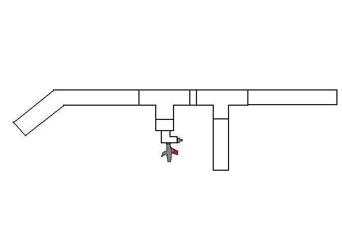

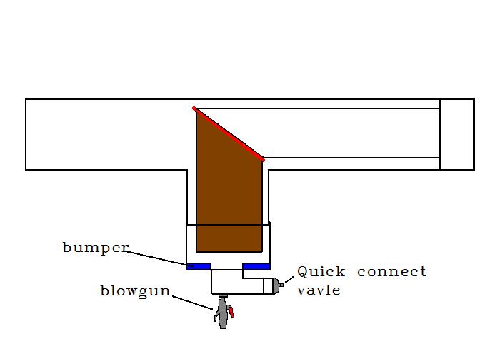

Hello these are my plans for a semi auto. It will shoot power popper rounds, since I am not allowed to shoot marbles. (my parents are worried about the effects that marbles can have on windows if picked up by a lwan mower)Image
The benifit of these is that they form a perfect seal in 1 inch pvc. also If I shoot them at a low pressure (20-40psi) I can cap my frineds with them, and they can return the favor. ( we are building our own guns to skrimish with, they just use my designs and make me go to the hardware store to help gather parts) I was planning on using regulated CO2 from a paintball Co2 tank and using a quick connect. if I chose to fire at a hirer psi at targest the max I would take it to is 120-160 psi. Is this safe? I have read many mixed opinions about using co2 with pvc. I will use a remote coil to a vertical tank, so all the Co2 should be in gas form by the time it reaches the gun. Let me know what you think her are some drawings of the valve and the overall gun. The barrel will have a 1 to 1 ratio in reality. the pics are not proportionate.
Should I use a spring instead of a rubber bumper?

here is the overall lay out

Look up clide's recent clear valve; he did the same thing.

yes, this is a variation of one of Clides valves. (sorry clide I forgot to add that in the original post) and I have an Evil detinator, which will do the same job as the palmer (just a little cheaper) Will this setup work for semi auto shooting?

Your making this way overcomplicated.
You could do this with a sprinkler or a QEV easily.
What you need to work on now is the semi-auto feeder. I suggest a paddle type interrupter.

I do not want a commercial valve because they are not redily available in my area. also I enjoy making the valves. I am goint to use the second T in the pic with a length of pipe glued in as the mag. it will hold 12 or 24 shots (haven't decided yet) it will employ a shotgun spring glued to a washer to push the balls up. also the cap at the bottom will be a screw on.

Frankrede can you pleas elaborate on how your idea for the feed system would work?

A piston with an angled face is a bad idea, as soon as it rotates a little you're screwed. I would make a QEV type valve, small flow if you're going to use it for skirmishing as you don't need a lot of power and you'll get more shots per tank.
As to the "paddle" type system, have a look at mark's full auto marble gun.

thanks for the word of warning JSR, but I really want to see how this type of valve will work. What is a QEV style piston (maybe I will build that) is it a normal T piston valve?

A QEV style piston is pretty much a tee valve, and I would definitely put a spring behind the piston to help it reseat after firing otherwise you'll lose all your air after one shot.

The chamber will be pretty small, and is meant to lose all it air after each shot, than refill. I am making it fully maintanible. If I am not impreesed with the performance, I can tweak and experiment. BTW, I can't find a spring the size I need, any idea how to make them??? :?:

jitup wrote: I can't find a spring the size I need, any idea how to make them??? :?:
All you need to know ;)

Thanks for the info! I think I will keep looking for the right size compression spring, maybe I can trim one. seems like a hassle if you don't have acess to a lathe.
