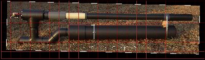

Sun Mar 10, 2013 6:28 pm
jackssmirkingrevenge wrote:Pics or it didn't happen ;)
You should be happy now. Yes?
Mon Mar 11, 2013 1:07 am
Ah, now we're talking :)
Specs seems a bit off though, you have your barrel listed as 4.5 feet and chamber at 2 feet, but the barrel is definitely less than twice as long as the chamber.
That's the one thing I would change, add a couple of feet to the barrel to really squeeze maximum performance out of it.
Looking forward to the videos!

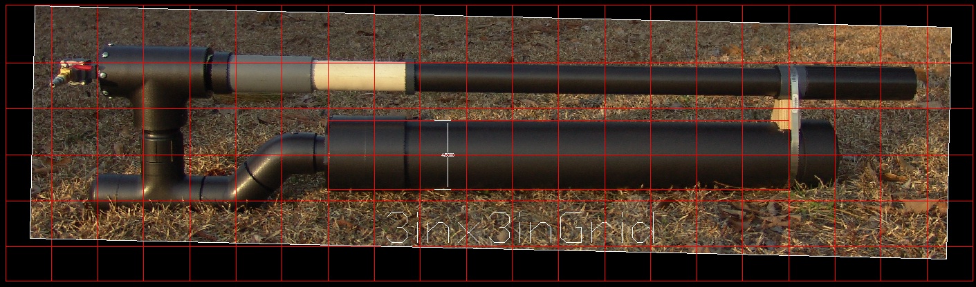

dewey-1
Posts: 1298
Location: NE Wisconsin USA
Mon Mar 11, 2013 8:28 am
Based on the 4.5 inch diameter of 4 inch SCH40 pipe, here are dimensions with a 3 x 3 inch grid scale.
Mon Mar 11, 2013 8:42 am
Maybe that muzzle sleeve allows a barrel extension to be fitted?

Mon Mar 11, 2013 5:23 pm
jackssmirkingrevenge wrote:Maybe that muzzle sleeve allows a barrel extension to be fitted?
I made it that way for a reason. The barrel was originally 6 foot 7 inches. I had to cut roughly 2 feet off. I can assure you that the barrel is over 2 feet long, and the chamber pipe itself is 2 feet long. I cut it off, because it was too heavy, and unmaneuverable.
Tue Mar 12, 2013 1:12 am
Maneuverability is relative :) you're not exactly going to go room clearing with this one, I would accept it being a bit more unweildy for the sake of MOAR POWAH!!!
