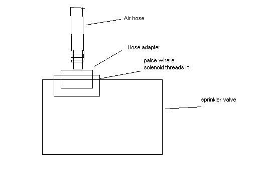

Instead of drilling a hole in the sprinkler valve could you get a hose adapter that can thread in where solenoid went? Because I have a U shaped sprinkler valve which I cant drill becaue of thingies in the way. How Blunt.
This is the hose adapther which will lead to a blowgun.
This is the valve.
This is the valve.
Sorry its a very bad drawing. Giant box is the sprinkler valve
draft schem.JPG (11.55 KiB) Viewed 7260 times

It depends on the style of the threads whether or not they are BSP,NPT, etc. I'm guessing if you want this adaptor you will have to get it custom made, maybe i'm wrong.

It would work a little better, but you would be better off drilling a hole in the center and doing it that way. You could try it.

It won't work because when you modify a sprinkler valve you enlarge the pilot hole behind the diaphragm, in doing so you are able to vent the pilot pressure from behind the diaphragm faster which allows the valve to open faster. If you modify it this way (by replacing the solenoid) you will still be using the same size pilot hole, the solenoid isn't the weak link it's the pilot hole size. so this idea won't work because your not increasing the flow of air from the pilot your just replacing the solenoid with a blow gun (or valve).
Okay. So it would work(sort of) so i wouldnt need my electronic control box anymore. Thanks for the help. I now understand it better now.

WOW!! wrote:It would work a little better, but you would be better off drilling a hole in the center and doing it that way. You could try it.
I would drill a hole but like i said." There is no room for me to drill it out.
