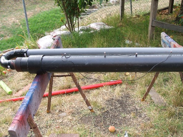

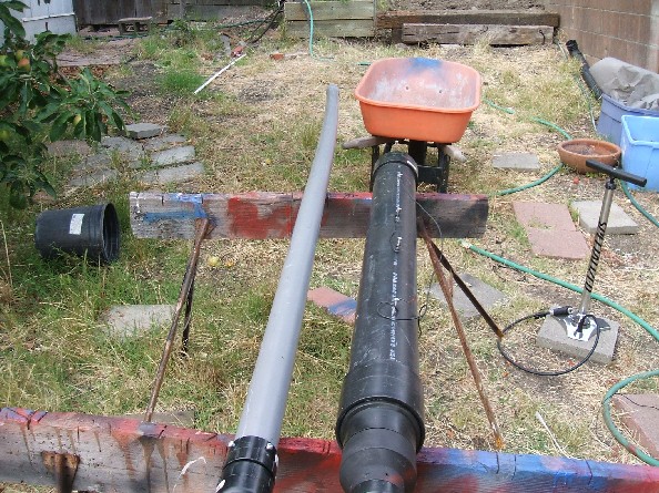

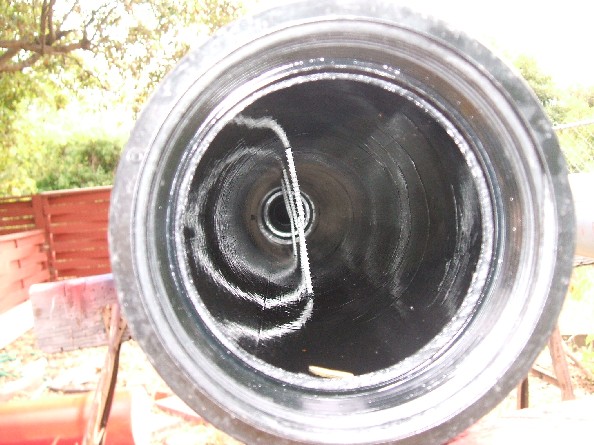

Just some big ass gun that cost me less than $20. The barrel (10 feet, 2" PVC) was 50 cents, the chamber (4 feet, 4" ABS) was 50 cents, and the BBQ igniter (4 sparks) was a dollar. All the other random fittings added up the rest. According to my calculations, I should be using 8-9 seconds of hairspray for the maximum bang, but only 5 seconds ignites. I think the problem is that the hairspray doesn't get into the front of the chamber enough. A chamber fan would help, but then I'd need a place to spray in the hairspray. Oh well, it's still strong enough to shoot through 2+ inches of wood with an apple.

i found that with my first spray combustion it worked to spray about half the fuel in, close it, up end it (so the barrel is on the ground) and wait a few seconds then open it and spray the other half in. that lets it mix up really well.

Wow. Thats one helluva cannon you have there. Is the BBQ ignitor a battery powered one or is it a piezo. I would assume it a battery powered one because the piezo would have a hard time creating 4 sparks. Isn't the barrel bent at the tip in the 2nd to last picture? If so why didn't you cut the bent part off?
Nope, it's a piezoelectric one. No one seems to understand that all you need for lots of sparks is, pause for suspense, small spark gaps! The barrel's bent a little, big deal. If I had another sawhorse or two I might be able to straighten it out.
