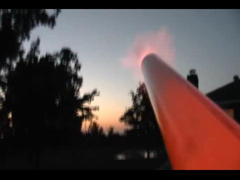

Took a still frame from the video and had to say... this looks really cool.. lol
Muzzle flash - unedited photo
