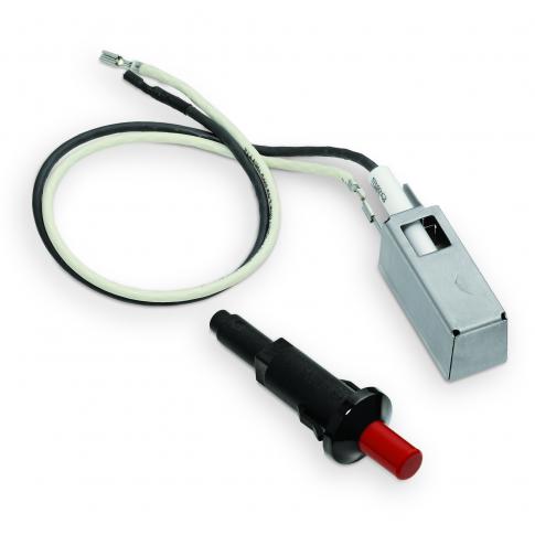

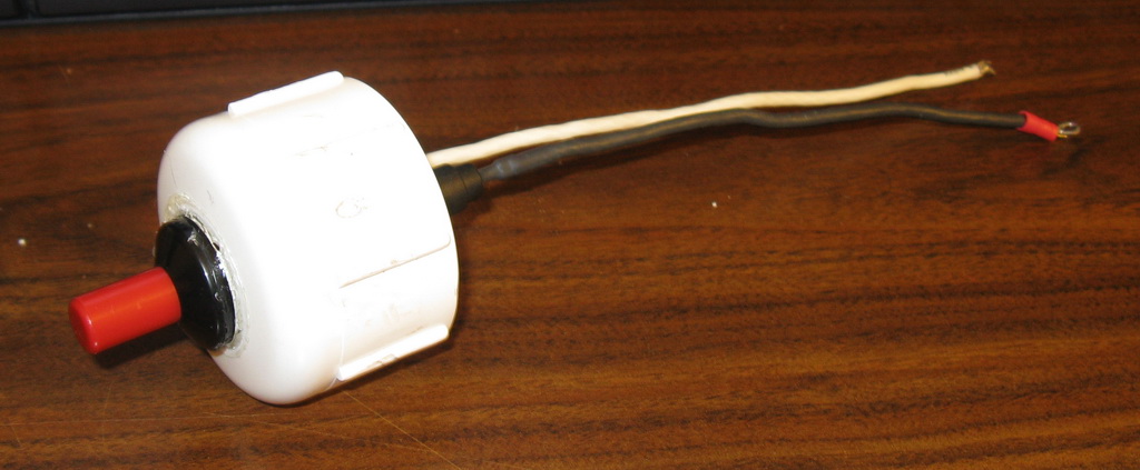

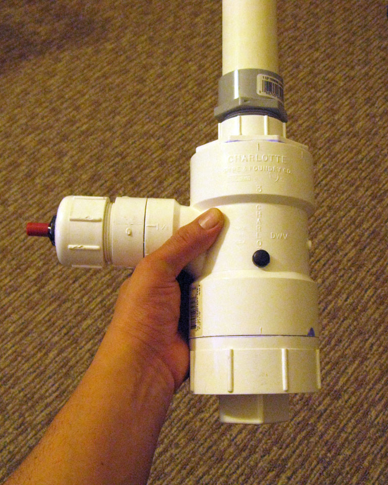

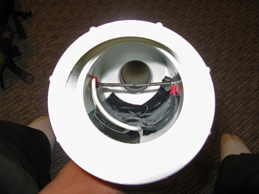

I get the Weber Ignitors, drill a 19/32 hole in a PVC threaded cap and glue it in place with PVC glue and some hot glue for extra help.

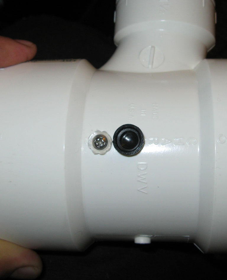

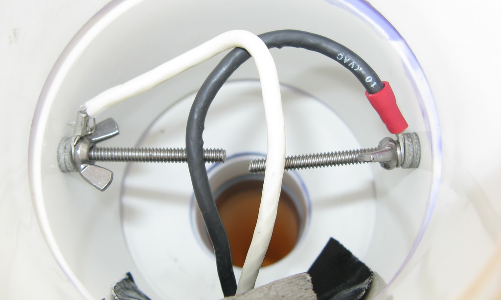

I then drill (7/64) & tap (6-32) two holes in my chamber, and find correct length of 6-32 stainless steel screws for the gap. I use 6-32 locking washer & wing nut to secure the BBQ wires to the screws inside the chamber. I finish it up with screw covers.

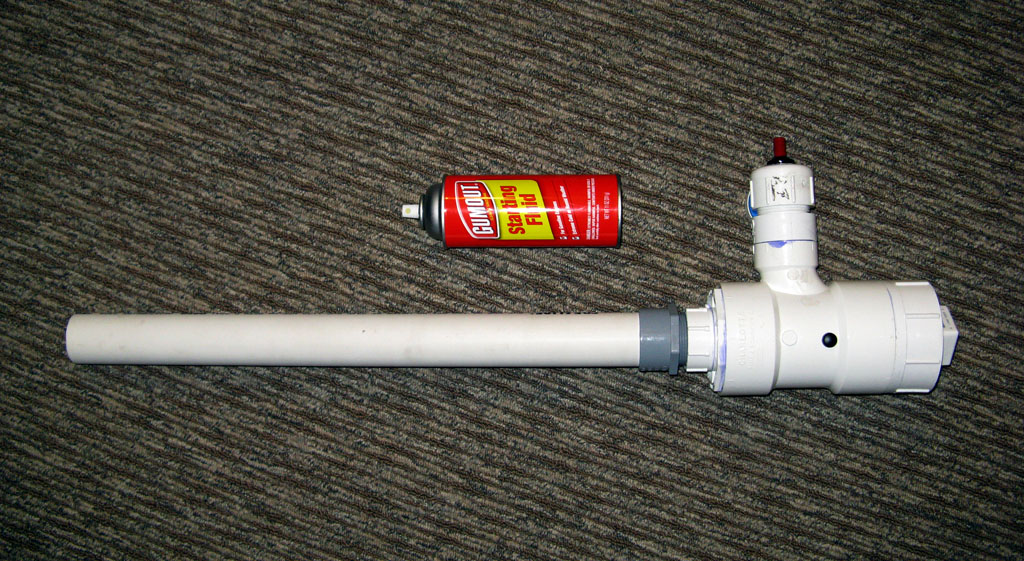

Here's my latest one:
- 3x3x1.5in Sanitary 'T'
- 3in clean-out adapter
- 3in plug
- 3in to 1.5in reducer bushing
- 1.5in female thread adapter
- 1.5in terminal adapter (from electrical PVC, it has a deeper female smooth area for better glue hold on barrel)
- 1.5x21.5in thinwall PVC pipe (160psi rating)
- 1.5 pipe about 1.5in long to connect the 'T' to a male thread adapter
- 1.5in threaded cap w/BBQ ignitor
- Gorilla Duct Tape to cover the 'T' hole
Side view of screw, snap & cover
Inside the chamber w/6-32 screws, wires, wing nuts.
Holding it in my hand
Size comparison to Gumout Starting Fluid can
Weber BBQ Ignitor
Weber BBQ Ignitor
Potato Cannon V3 - Spray & Pray .. soon to be converted to metered propane & chamber fan.

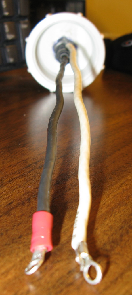

Not to thread jack, but my issue is with my design as described above.
I've been getting spark failure, somewhere between the button & the screws I see sparks. Since my tape is blocking my view I am not sure if it's sparking from wire to wire, or from wire to PVC wall.
I am guessing from wire to PVC wall. I've done dozens of sparking with the sparker & wires out of the chamber and twisted together, 100% spark between the crimped on ring terminals.
I am thinking of wrapping small bit of electrical tape on the very top of the screw. So when it screws into the PVC the tape should insulate it some. I am also going to add some fiber washers between the PVC chamber & ring terminals.
Another angle
Another angle
BBQ sparker glued to threaded PVC cap.
Joshatdot
Posts: 29
Joined: Thu Oct 15, 2009 2:38 am
Location: Anacortes, WA
Wed Jan 06, 2010 12:03 am
Well I thing the fiber washers on the inside is working best, the tape on the top just kinda squashed out and didn't get into the threads.
I've done 40+ dry fires, and they all sparked between the screws.
Final, hopefully, working solution.  See the fiber washers =)

PVC does not conduct. However, it looks to me like your wires are crossed. IMO, even if insulated, the two wires are the closest point - closer to each other than the tips of the spark gap. Also, your gap appears to be a bit large for a BBQ ignitor.
jimmy101
Posts: 3209
Location: Greenwood, Indiana
Has thanked: 6 times
Been thanked: 18 times
Wed Jan 06, 2010 3:16 pm
What boomer said. Shorten up the gap to perhaps 1/8" or so and if you can sharpen the screws to points.
Joshatdot
Posts: 29
Thu Jan 07, 2010 3:47 am
As I said in previous post, I have tested the wires twisted around one another, out of the chamber...100% spark between the ring terminals. Ever since I've added the fiber washers, all sparks have been between the screws. BTW the spark gap is about 1/4in or less, which is about the same/or less then the original crematic probe & collector box spark thing.

Boom_erang
Posts: 61
Joined: Fri Apr 25, 2008 2:26 pm
Thu Jan 07, 2010 11:21 am
Sounds like you're good to go!
