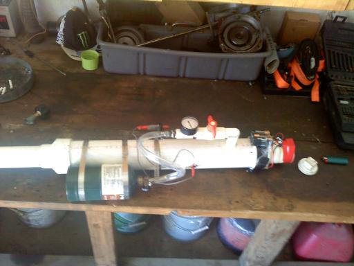

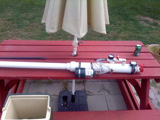

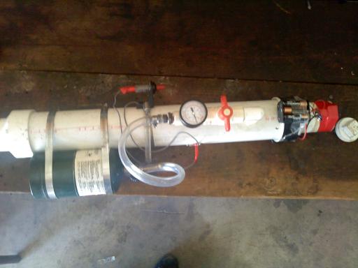

well this is my second gun ive made the only problems ive had is the ignitor so i ordered a electric ignition system i hope it works better if any one has iseas or see's a problem in my gun let me know

Looks good but your reducer looks like DWV

dwv what would that be? my grandpa is a plumber so i got the matrial from him its all sch 40 pipe is that reducer bad to use or something thanks for your input

DWV= drainage, waste, vent. Not rated for pressure.
As long as it isn't cellular-core you should be ok using dwv for a combustion(In all probability it isn't. Not sure about your chamber pipe though).
As has been said countless times, sch40 is a wall thickness, not a pressure rating. If you want to use pvc in a pneumatic it should have"nsf-pw" printed on the fitting or pipe(It indicates use in pressurized water systems).

Fnord wrote:DWV= drainage, waste, vent. Not rated for pressure.
Cellular Core ABS is great for traditional combustions. See my sig for a link to an ABS test.
I do agree that PVC DWV should not be used. It's fragile.

and that's not all he also drilled his electrodes strait onto his chamber wall :shock: . i really hope you aren't planing on firing this this any time soon.

I thought we came to the conclusion that DWV is fine for advanced combustions. Now, lets take the DWV, ABS, XZY argument somewhere else.
Great gun for a second, It may need some cleaning up. Once you get your electronic igniter you can mount that plus your fan circuit in a nice looking project box.
Do you get consistent results with that meter?

yea i put about 40 psi in it turn on the fan and it shoots a potato about 400 yards everytime and im just waiting for my electric ignition to get here to finish evrything up i have a box to mount all my switches in i hate the push button ignitors they always give me problems and as far as my ignition being drilled into my chamber wall every gun ive made has been like that and its never been a problem

My DWV cannon has a fill through the side in a single layer and it has shown no signs of failure. My Mouse Musket fills through a single layer. Overall I have not seen much evidence showing many failures due to the placement of small holes in pipe. Joints, end caps, and fatigue failure of components appears to be more common.

this gun is less than a week old and ive shot it about 50 times and there's no signs of failure anywhere on some of my past guns which were none propane there would always be burn marks next to my ignitor which i didnt like so know i put some seal all around which can withstand temps up to 180 and its seems to work pretty gun i didnt a test fire today with a 6 ft wire on my ignitor and about 60 psi of propane and i shoot a apple about 700 yards :D it was pretty crazy im in the prosses of making another one out of stronger pipe my goal is to be able to shoot 1000 yards which is the lenght of my corn fieald behind my house
