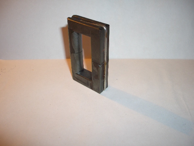

Fnord, I have been tinkering around with a flyback based ingition for a little bit and have access to almost anything related to coil winding. I have been unsucessful in using the existing windings in the flyback so I removed the core to give winding my own a shot. Have you found any sort of data on coil resistences, wire sizes etc? Any help you could provide would be greatley appreciated!
A pic of the core I wanted to use
Thu Nov 11, 2010 9:46 pm
If you wind for a regular ignition coil, the turns ratio is typically 100:1. That way an inductive kick in a Kettering system produces about 300 volts in the primary and 30KV in the secondary.
You can feed the primary with either 12 volts DC and interrupt the current with a condenser on the switch to generate the primary voltage from inductive kick, or use a capacitive discharge to dump a 300 volt charged cap into the primary
Typical turns are 200 turns in the primary and 20,000 turns in the secondary. Proper insulation will be needed to prevent arcing in the secondary. Use wire sizes that fit the space.
The difficulty many people have with flyback transformers is the primary is not designed for 12 volts DC like an ignition coil so the turns ratio is unknown and have many coils on the primary side as a power supply for other parts of the monitor or TV.
Often simply adding your own primary and using the exiting the secondary is a way to use those.

Depends on how much voltage you want to get out of it.
It takes about 11kv for a one centimeter arc, so 10-20kv is usually fine.
You'll probably want somewhere around of 10 primary turns of heavy wire(20gauge-ish). Flybacks are not too picky about this but may run hot if you use to few. Flybacks are not wound like a standard transformer. You'll have a voltage spike in there experience using too few will cause it to run hot.
Maybe 5 turns thin wire for the feedback coil. Again it's not too critical.
Now, I've also found (and been told by others) that the turn ratio does that will multiply your input voltage by around x4.
So if you're using 12v, you'll want to treat it like 48.
for 11kv:
11000 / 48 = 230
Take 230 * desired number of primary turns. The wire should be as thin as is practical for you to wind. I've also heard some people mention that it's best to use slightly fewer turns every time you start a new layer.
You'll need adaquate insulation between the coil layers. Teflon tape works well. Try arcing though some layers of it with a peizo ignitor(w/ small spark gap). When you can't get a spark through it you'll know about how many layers to use.
If you get really ambitious you can try submerging it in mineral oil and vacuuming out the bubbles for extra protection.
