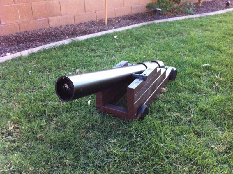

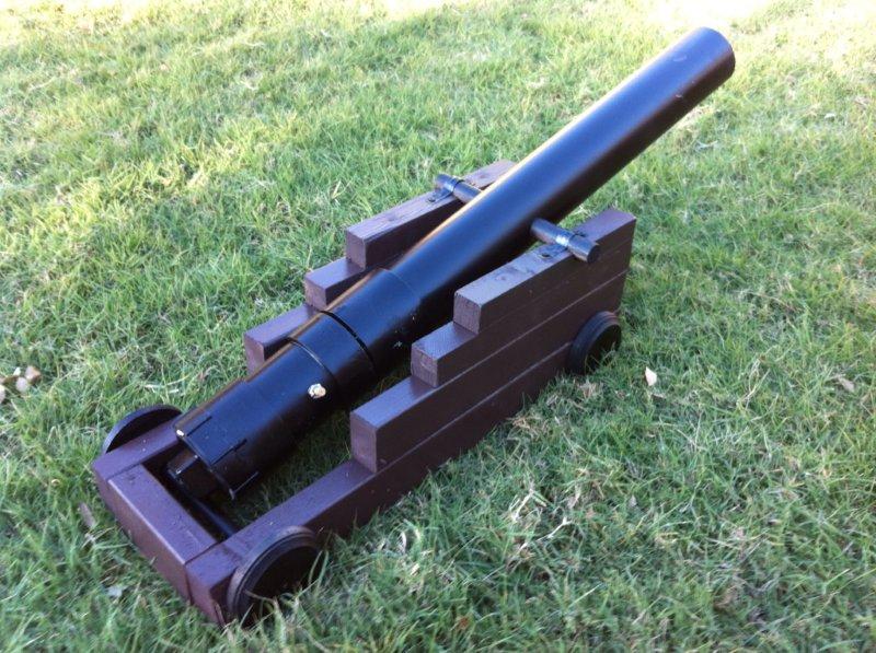

So my nephew got a little toy potato pop gun. He loves it. For his birthday, my wife asked me if I could upsize it into a potato gun. He is a big fan of pirates, so I thought I'd theme it. Well, the project got a little more... complicated than I first thought. But the end result was better than I had hoped. Its only my second potato gun, but the first was a LONG time ago.
Let me know what you think,
Jeff

Thanks for the positive feedback :)
OK - my nephew is WAY too young to play with it by himself, so his dad really is the one who gets to fire it.
This cannon has a 3in combustion chamber that goes to a 3/4" barrel. It was build using Mini T-Rex plans over at AdvancedSpuds.com as a starting point.
I'm using lantern flint sparker as the ignition source.

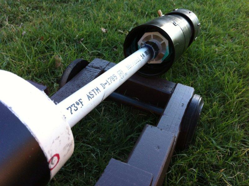

After building the cannon close to a Mini T-Rex, I just pvc welded the 3" coupler right on top of the reduction piece. This allows my to fit it to the back of a 3" cannon to match the combustion chamber. The trick was how to get the 3/4" barrel through the center of the 3" outter barrel when there is a 3/4" wood dowel going through it to support the cannon on the base. This required a 3/4" "T". I dremelled the inside of the "T" out enough to pass the 3/4" internal barrel through it cleanly. I then cut the dowel into two, and screwed it to the inside of the other path of the "T". Attached a picture to give a better idea.
Kids LOVE it. Makes a nice big boom. :D
