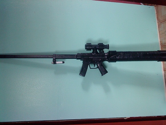

Hi,this is my first ever built.I made it from a MP5 toy gun.and these are some materials I used.
3' of 1/2" pvc pipe for barrel.
2' of 2" pvc for chamber.
2" to 1/2" pvc reducer.
battery operated kitchen igniter.
1/2" T joint for scope.
laser pointer.
epoxy,black paint & some wire.
By the way I used methanol as fuel and glass marbel as ammo.I just squirts the methanol 7 to 13 times into the chamber from end plug located at the end of the chamber,load the marbel from the barel and shoot.It's a very simple basic design,but look cool I guess.

looking good! I like It :)
Have you considered syringe metering? normal metering would ruin the looks.

Thanks for liking,actualy this one only experiment for me.I'm working for my 2nd project.I'm planning to built a piston hybrid with metered butane & semi auto bridge loader.

wow, thats a big jump! :shock: most people prefer to start with a burst disk hybrid to get a feel of hybrids in general. However, If you feel your up to it, go for it!
