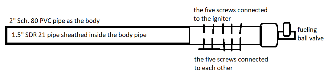

I wanted to make a combustion cannon that would not only have great performance, but also would be sleek and durable with an endless supply of high performance ammo.
So I decided to make this.
The cannon is a 4 foot piece of 2" Sch. 80 PVC with a 3 foot long section of 1.5" sdr21 shoved into it to make the barrel. The body of the cannon also operates as the combustion chamber, making it require almost no fittings!
To bump up the performance, I rigged together a 5 spark electric barbeque igniter (which took some fiddling with to get to work). Finally, to make fueling fast and easy with no fumbling, I added a ball valve at the rear to make fueling fast and easy. It is meant to fire golf balls.
the basic design plan
golfball bazooka.png (12.87 KiB) Viewed 9454 times

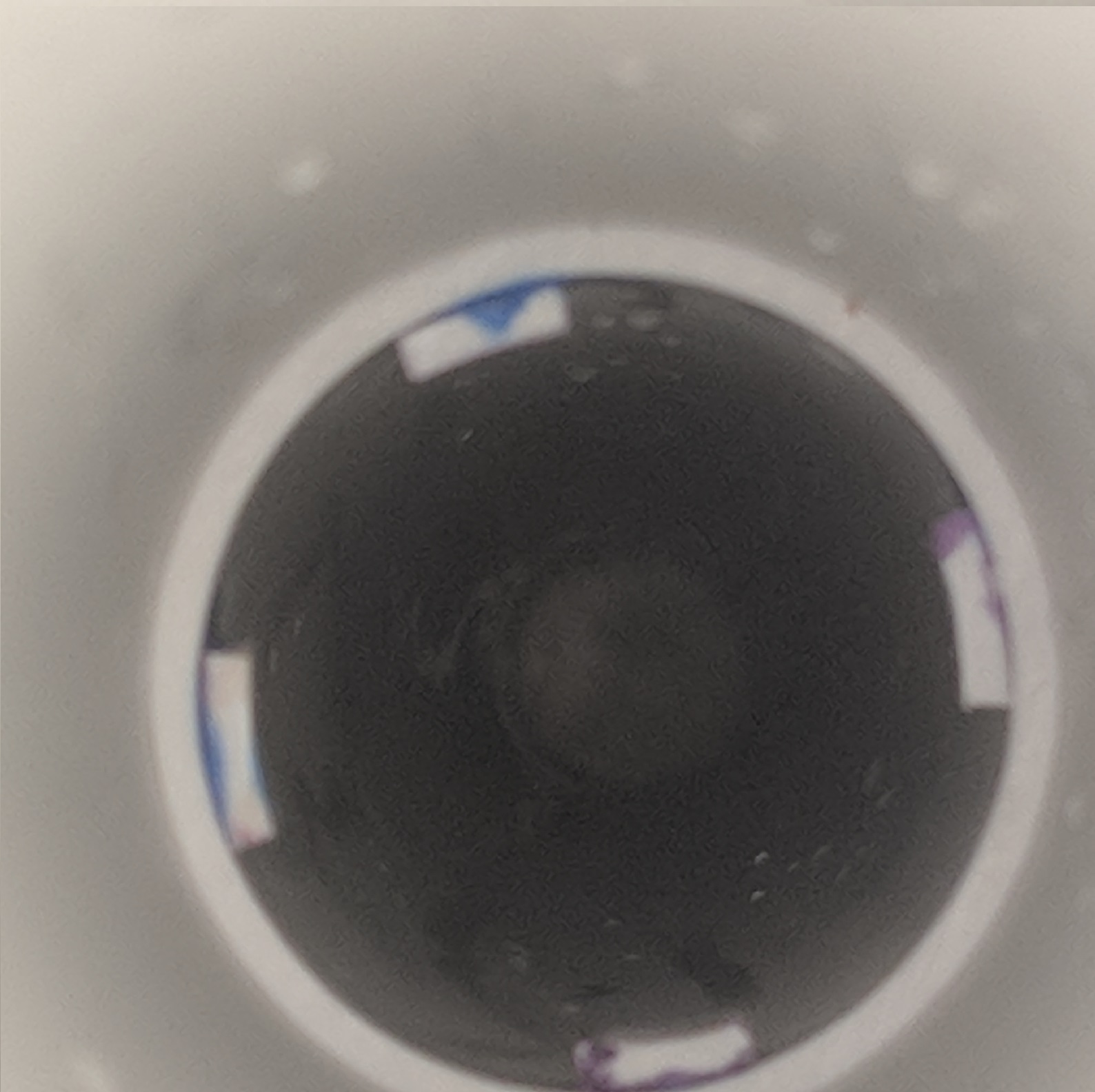

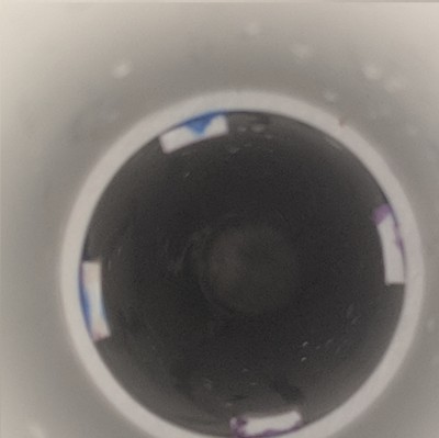

I also glued a few cut pieces of pvc inside the barrel to work as a ball catch, preventing the golf ball from rolling into the chamber.
The ball catch
The ball catch

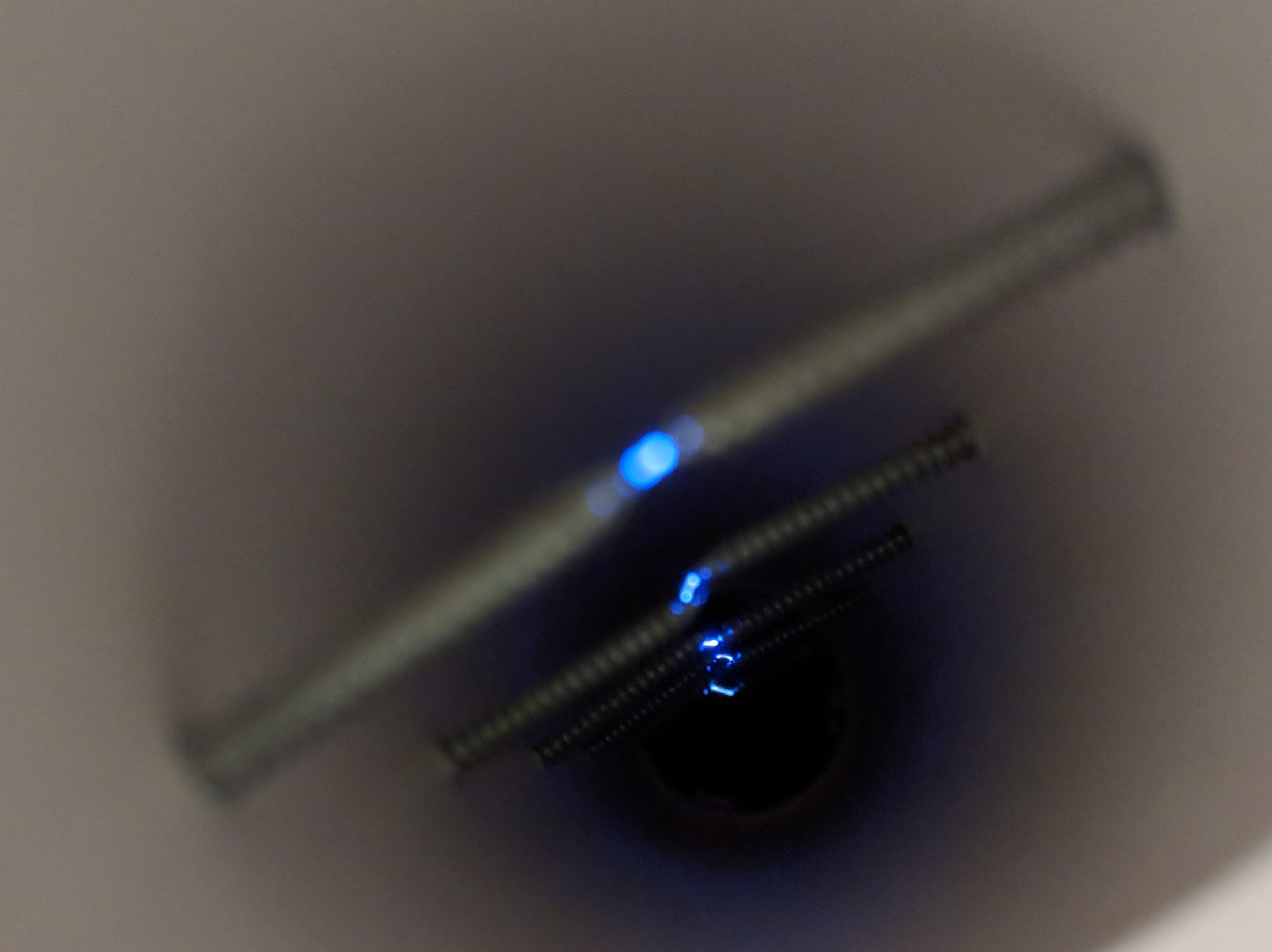

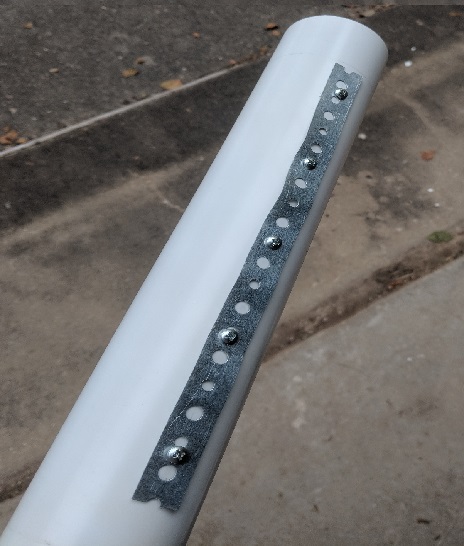

The screws not connected to the bbq igniter had to be connected to each other (for magical electrical reasons as I was told by my electrical engineering friends :lol: )
a strip of metal I found with holes already drilled in it worked great for connecting the receiving electrodes!
But it was definitely worth it.
5 beautiful sparks!
5 beautiful sparks!

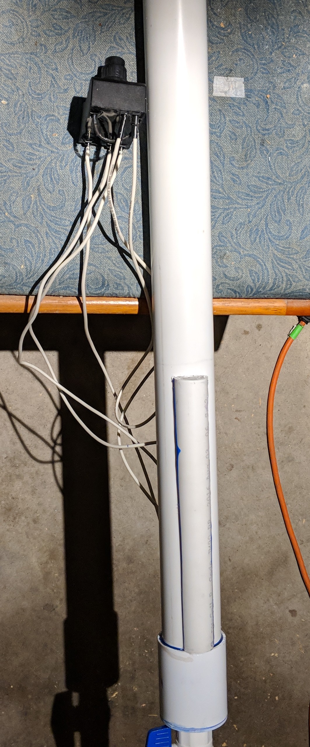

The problem I've been having is figuring out a way to effectively attach the igniter so that it can be fired over the shoulder (like a bazooka).
The dangling chords and igniter don't make this very ergonomic...<br />You can see I glued a piece of pvc sliced in half over the connected electrodes so that the metal strip doesn't snag on clothing.
Does anyone have any ideas on how to attach the igniter? Suggestions on how I should paint it and optics for aiming would also be amazing :P

Nice, how are you metering the fuel?
Tee connection on the barrel?

I thought about using a T-fitting with a slot cut in it to fit the igniter module, but I think that the module is larger than the diameter of the 2"pipe so it might not fit unless I do some heat bending.

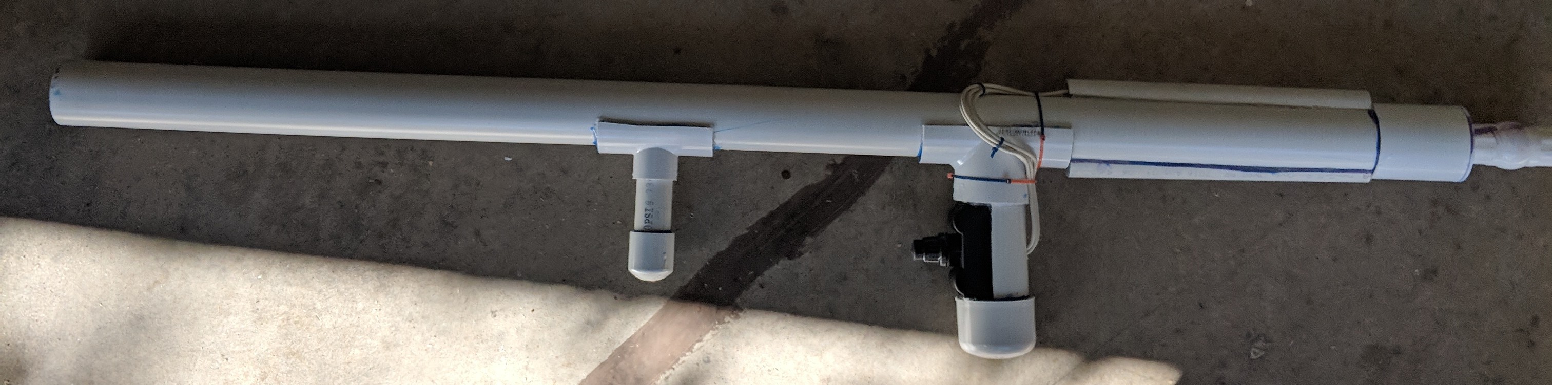

Made great progress! :D
Took the advice and used a T-fitting cut with a piece of pipe cut in half. I didn't bother with the heat bending and just hot glued the module to the sliced pipe and it was sturdy enough.
I also added a foregrip for stability, zip tied the wires down to keep them organized, and glued another half pipe of PVC to the other electrodes to protect my face from being shocked if I accidentally push me cheek too close to the pipe.
It's pretty comfy to hold! And since the cannon is so heavy there is very little recoil.
Anyone have ideas on a cool paint scheme or what kind of optical system I should attach to it?

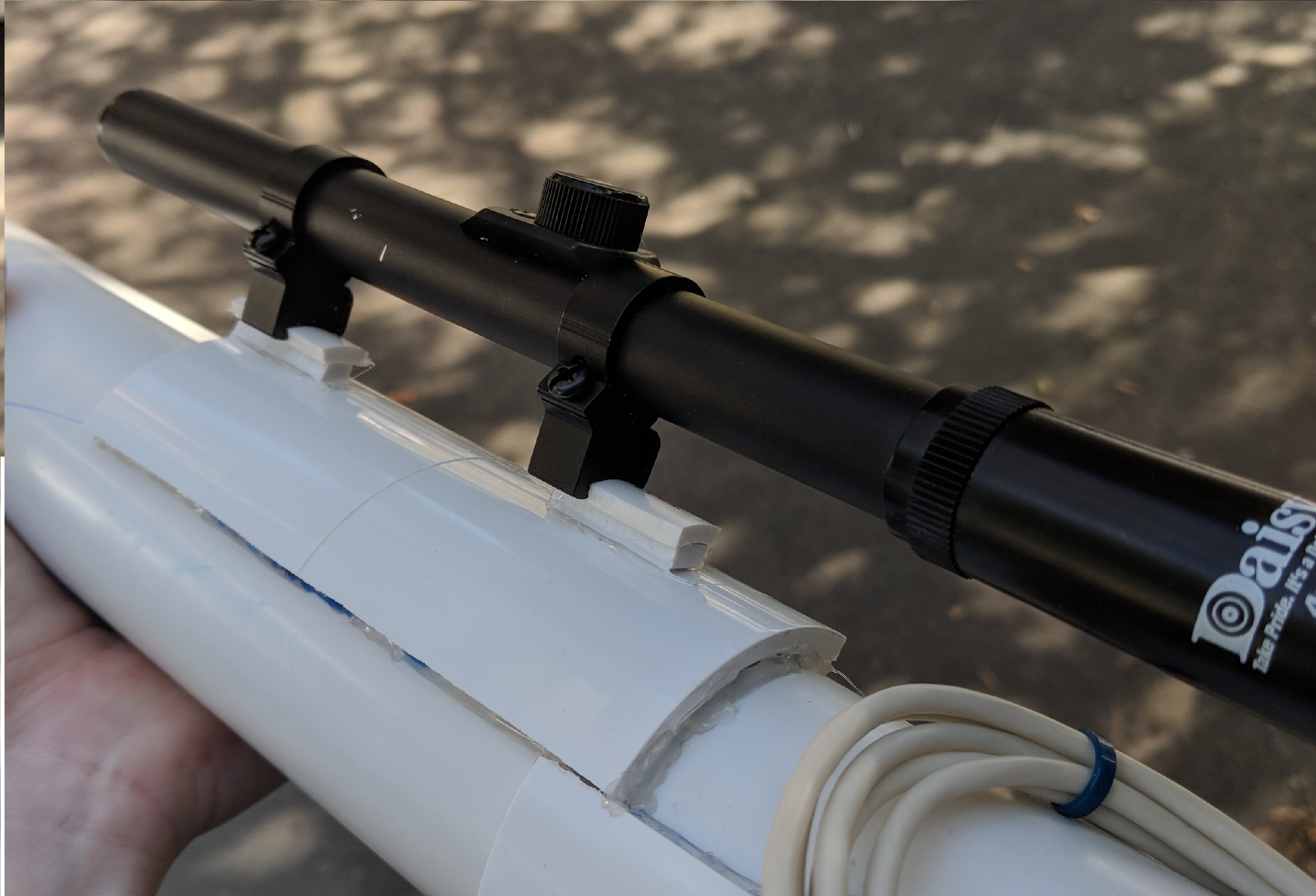

jackssmirkingrevenge wrote: OD Green would be traditional, and I would go for a cheap Chinese red dot or low magnification scope on the side, have a look at recoilless rifles for inspiration.
Good idea! I have both of those on hand right now! Hopefully I'll be able to find a way to make dovetails for my scope to attach to though (maybe strips of pvc sanded down until they fit).
Sat Dec 22, 2018 9:01 am
Cthulhu wrote:Hopefully I'll be able to find a way to make dovetails for my scope to attach to though (maybe strips of pvc sanded down until they fit).
Isn't it easier and simpler to just buy something like these for a few bucks and bolt them on?

jackssmirkingrevenge wrote: Isn't it easier and simpler to just buy something like these for a few bucks and bolt them on?
If I wasn't an unemployed college student then maybe!
Until I have income I'll have to settle for hodgepodge pvc construction :lol:
good 'nuff for now
