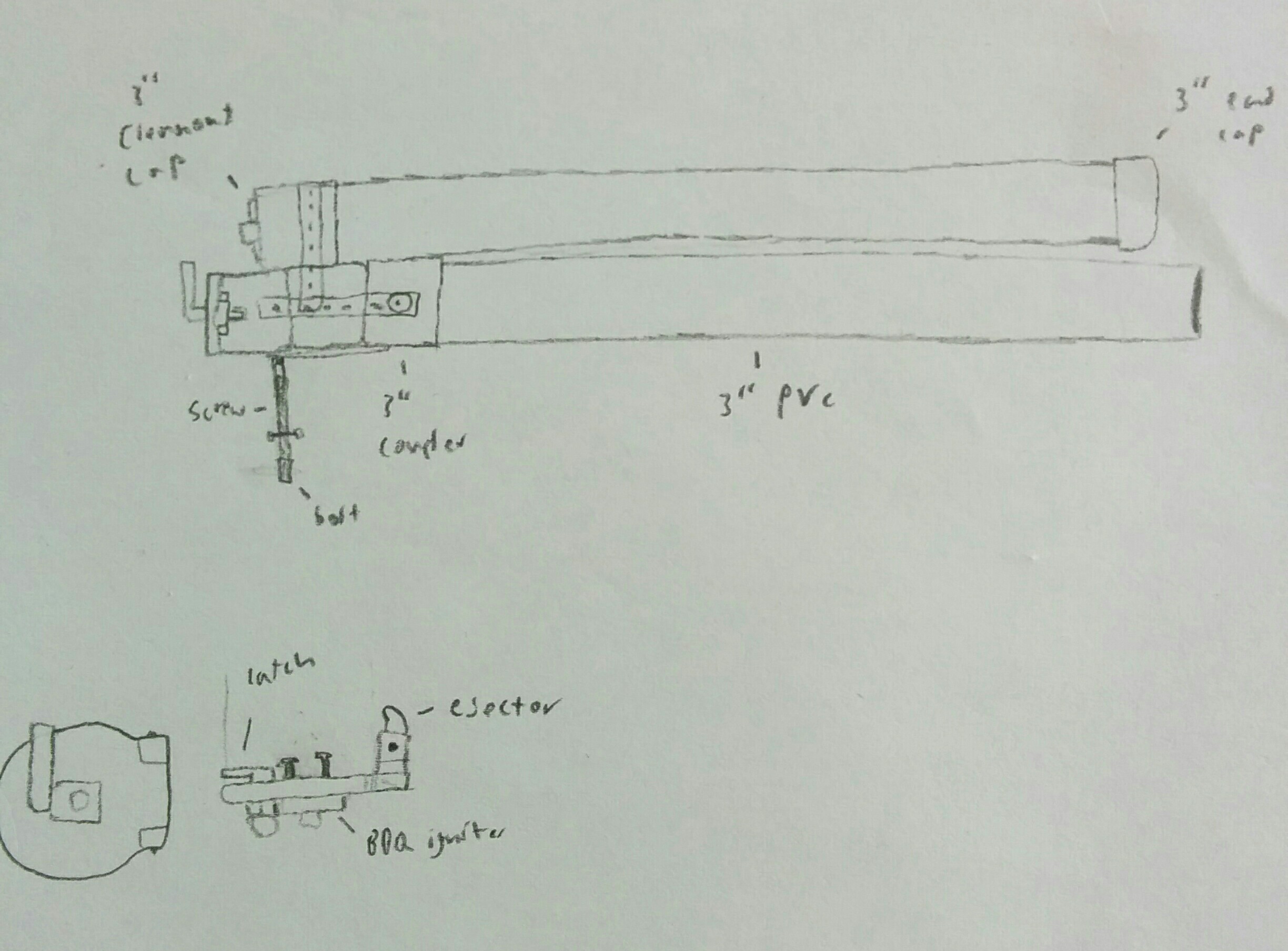

Here are the rough (I repeat: rough) tentative blueprints. The main area of interest is the chamber for the round, which is composed of 3 couplers that have been sanded out on the inside to accept a 3" cartridge smoothly. To increase the strength of these couplers they are attached by 4 punched metal bars with screws binding it all together. It is from these punched bars that mock recoil assembly and elevation system are attached.
As for the breech, it's a simple wooden flap attached to a hinge on the side of the last coupler with a simple latch to lock it in place. The only really neat thing about it is the ejector, which is a curved piece of wood that enters a slot in the PVC when the breech is fully opened, gripping the cartridge rim and pushing it out enough to be grabbed.
I don't really like the current chamber design as it seems quite finicky, but it will provide a much more precise fit than a 4" PVC and adaptor.
Excuse my awful drawing

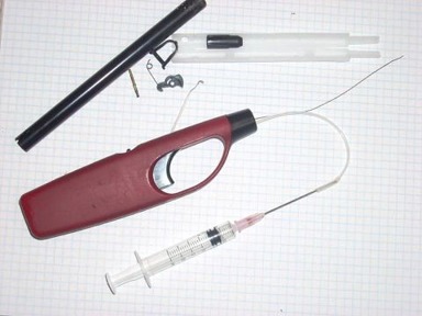

As Dave said early on, the ONLY thing that really matters in terms of fuel is getting the right amount in the gun. It is easy to build a meter for either propane of butane. A long handled butane lighter in particular is easy to mate with a syringe.
http://www.inpharmix.com/jps/Fuel%20Met ... ghter.html
http://www.inpharmix.com/jps/Hacking_lighter.html
The piezo ignitor in the lighter can also be used as the ignition system for the gun.

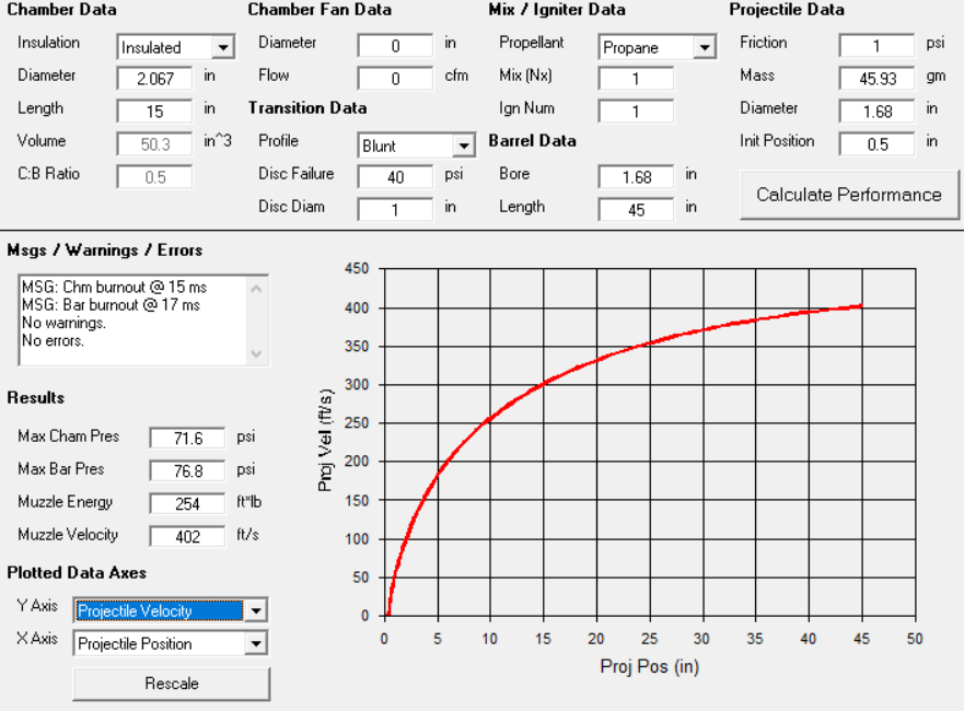

This time I have multiple successful combustion guns under my belt and I actually know how to use HGDT :lol:
Here's a really crappy animation I made showing my idea (sorry for the bad lighting and the rapid speed, still learning):

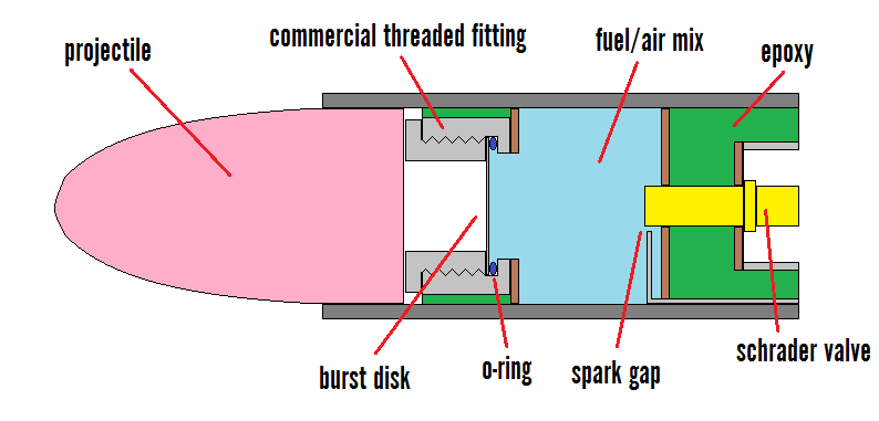

The body of the cartridge is 2 inch PVC pipe that's 15 inches long. The base of the cartridge holds a screw that doubles as an ignition electrode as well as a fueling port along with another electrode that is attached to a washer (to make the cartridge symmetric and easy to fire). The top of the cartridge has a permanently installed disc upon which an aluminum foil burst disk is placed. Over this, the second half of the burst disk assembly fits on with 8 screws and is sized to hold a golf ball (or any other 1.68 inch diameter projectile).
Not amazing performance but pretty good for being on a budget! HGDT did show an abnormal increase in power just from slightly strengthening the burst disk but I'm hoping this will happen in the real world.
The debate now turns to what to make the cartridge base/fueling port/electrode holder and the burst disk holder out of. I could fiddle with dimensions and 3d print them or I could cast some epoxy resin into cylinders roughly the diameter of the pipe and turn them on my wood lathe, not sure which would function better :?
I think what is missing is in this drawing of Jack. The truth, and after giving a few turns in my head to the issue of a hybrid cartridge, the design with rupture disc is the best. It solves the retention aspect of the compressed mixture, solves the regulation of the pressure peak, solves the ability to use a magazine with several cartridges inside and use as a repetitive firearm, without needing a dispenser, air tank, valves etc, on board of the weapon It is a proven and viable technology, and not much technical complexity to manufacture.Besides, you can throw pellets, bbs, and any projectile of the caliber one has.
