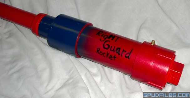

BL Series with a black and red paint job

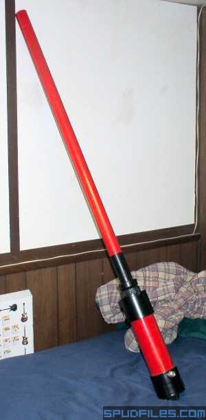

This one I built for a friend and She's a GIRL hehe proof that at least one lady owns/likes spud guns : ) !

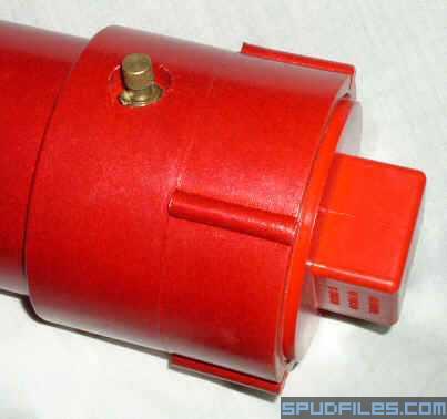

Lantern Lighter installed

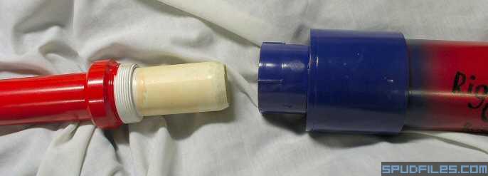

Breech Loading Detail
