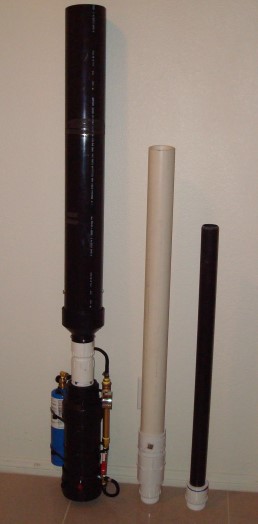

My multi-barreled gun has a propane setup now. I can tell the difference between using Gumout Carb Cleaner and using the propane. Very consistent and about 20% more powerful. Hey, I still have to give Gumout it's props...it's still pretty good.

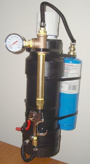

I wrenched off a propane torch top and used hose from a broken bicycle pump. The hose after the blowgun screws into a tire valve.
Softball w/Gumout distance (measured with a GPS) = 686 ft
Softball w/propane distance (measured with a GPS) = 885 ft!!!
Dialing it in today for a couple of hours was FUN! The softball attachment requires a little more propane than the other barrels. The rigging is zip ties for now until I build a nicer housing for it later.

- all the barrels
- softball_cannon.jpg (31.42 KiB) Viewed 3008 times

850 feet is some wicked distance with a softball, thats a 4 inch chamber right? and about what psi do u use. great job!

4" chamber, 4" softball barrel (seated 4" above the breech to create a larger combustion chamber.Spuddin wrote:850 feet is some wicked distance with a softball, thats a 4 inch chamber right? and about what psi do u use. great job!
With the propane setup I have, I pressurize to 30 psi and when using the softball barrel I use 36 psi.

Very nice! You've been making a lot of headway the last few days. Once you go to propane you wont want to do anything else. Looks like you've the fuel/air mix right too. MAPP offers a little more energy, however, without a burst disk setup, it's unlikely you'll see a significant performance difference from propane.
On your meter, you decided not to use a valve to close off the propane tank from the meter...?? How are you injecting the right amount? Resticter and quick shot method?

There are 2 valves. There is a valve on the propane can adapter (hidden from view in my pic) and the blowgun is my other valve. I could have used a ball valve in place of the blowgun but I think this way looks better.
