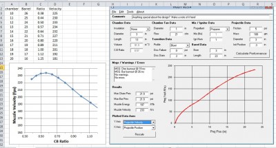

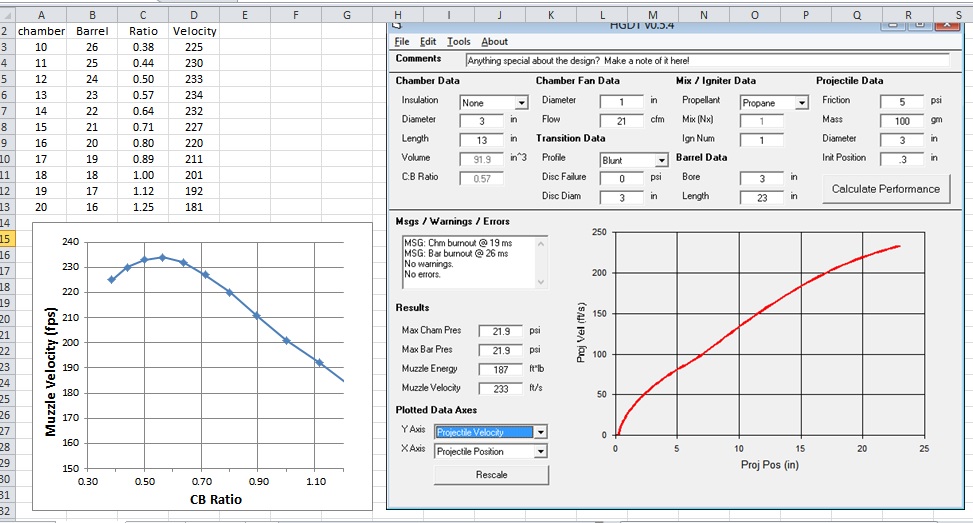

Everything in the HGDT parameter set has to be set right. Here's an example for a 3" x 36" "monogun". The ammo mass and friction values are WAGs. On the right is a screenshot of HGDT, on the left is an Excel sheet where I collected data as I swung the chamber to barrel composition with a total length fixed at 36".
