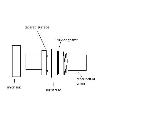

Now I have come to a stage in my Hybrid Build were I am wondering what to do.I could use a Cam Lock as a burst disc holder or use a Union,both are made from Aluminium.A Cam Lock would be a lot quicker to use and doesn't have the problem with the tapered contact surface like in a union,I have heard that they have a problems with the burst discs being cut or sheared off from the tapered edge.But the Cam Lock has a rubber gasket to seal the join and this is a definite weak area and most probably would be ruined after a few shots with the gasket most probably being ruined from the temperatures,does anyone have an idea on why I should use one over the other?

I'd go with the union. All that a tapered surface means is that you get clean, circular bursts every time.

SpudBlaster, there are union gaslets for a reason, you know. :wink: I got one for $.20, and put the burst disc between it and the tapered surface. Not once have I had any leaks or anything, and no modifications were needed.
