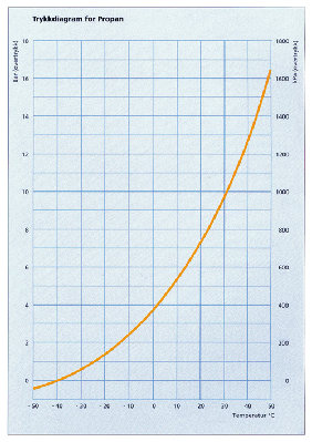

How high mix hybrids do you think its possible to build?
Can you go above, lets say, 15x, 25x, 50x 75x, 100x or even higher?
To clarify i am talking about Air-Propane, not Oxy-Propane.

The limitation is the liquifaction pressure of the mixture. Propane liquifies at a fairly low pressure. What's the pressure in a propane tank at 70F? 150 PSI or something like that?
So you can't get anywhere near 100X.

The highest mix you can achieve depends on the temperature.
At 70*F the vapor pressure of propane is 110psi. This means with a partial pressure of roughly 4%, you are limited to 2800psi, or around 190x, before any extra propane turns to liquid.
Of course building a cannon that can hold 2800psi is a bit of a challenge in and of itself. Trying to ignite a mixture that is at that pressure is something else entirely. It is 'possible' to build a launcher to contain this, so there's your answer, but I wouldn't hold me breath on seeing one.

on 100x you want 4.3bar of propane and that is totally doable.
the limit will be 200x then the pressure is 8.6 bar and that is also doable since.....
a little over 20 celcius and a 200x is in your hand

Of course one can see from both SpudFarm's post and mine as well that the ambient temperature is the big factor here. While a person in one part of the world may be limited to 120x, another could achieve twice that just because it's a warm day.
But, it doesn't matter if no one is willing to take up the geometric increase in cost that is associated with an arithmetic increase in performance.

but if you want to go onto a like 1000x isnt it just to messure and calculate the amount of liquid propane needed for that shot and then have a flow messure instrument like they use on the fuel line on cars to find out how much fuel it use, so you can messure it out? it will make sence to me that it turns to gas when it gets 999bars of air on it and it is just 4.2% of gas in there again :?
