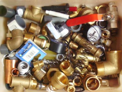

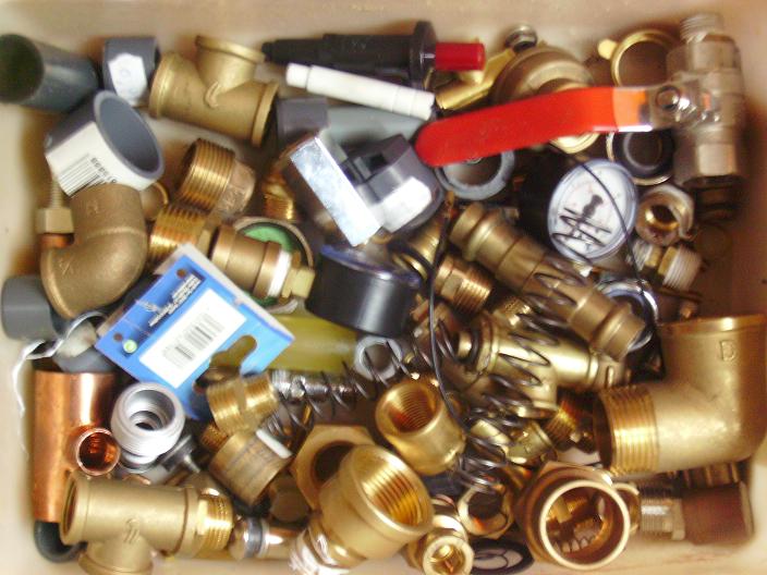

today i found in my personel"pot of gold" this brass fits!
jean
mmmhhh.... verry small
pot of gold ;)
pot of gold ;)

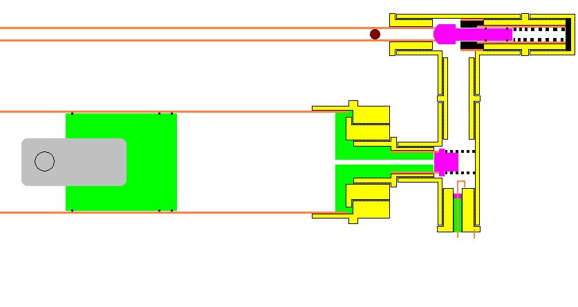

first i will use a syringe instead of a pump to test all (seal, combustion, piston work, inigtion.....)
after i will build an fuel sytem like the "firestorm omega" visualised in Theories/Accessories Database ( http://www.spudfiles.com/forums/firesto ... 14507.html ) conformed to hybrid.
1. mixing the fuel in pump
2. pump in chamber to xbar
3. inigtion
mh but i dont know how essential it is to vent the chamber after every shot!?
i hope it is not so important at 5x, 10x or 20x.....

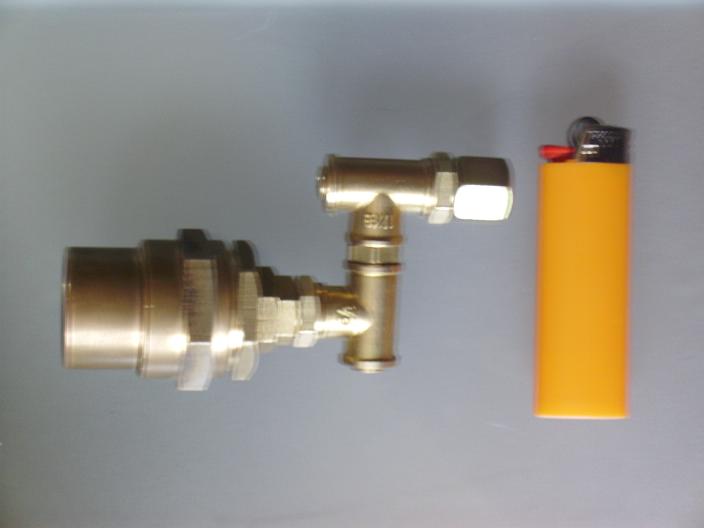

today i change the solder fitting to pump (pump id now 20mm) and attach the barrel ( 5mm id brass tube).
its not so easy as i wish.... drill out a 1/8 plug but a little out of square
next day i will a secend try.
