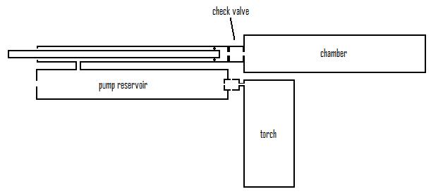

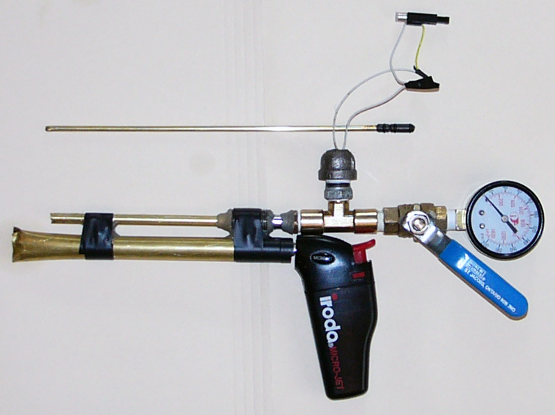

This fueling system uses a small butane torch to mix the fuel/air, an intake chamber, and a small pump consisting of a piston, equalization or intake hole, and a schrader valve.
It is a workaround for fueling small hybrids that are hard to meter without very precise gauges. It also does not require a regulator. If you initially measure the number of pumps required to reach each mix number, you can precisely control the combustion pressure without a gauge on the finished cannon. This makes it easier to design compact cannons.
Because it uses a threaded schrader valve as a check valve, you can use common steel pipe for all the high pressure parts of the cannon, making for a simple and safe build.
Here it is in action. This was the third firing, and the chamber was returned to 0 psi after each, but not vented.
This is a fairly simple build. The most challenging part is the pump, but I had a piston already made for something else, so in this case all I had to do was drill a few holes and glue a few things together.
Edit: added quick diagram.
I thought it would be more clear for searching and future reference to start a new thread. If not, could a mod please merge this with the initial thread, below.

Good idea, but wouldn't it be better to let the pump piston move back because of the pressure from the torch(in other words: let the torch fill the pump). Then ofcourse push the pump rod down and fill the chamber.
Because pumping as fast as you did in the video is imo screwing the mixture :roll:

Using the torch pressure to draw back the piston wouldn't work because if there is too much back pressure, the butane will just flow out of the air inlet holes on the torch.
As long as the flow of the torch is adequate, it doesn't matter how fast you pump. The pump just compresses the fuel and air which has already been mixed at the correct ratio in the torch. Though I am considering some sort of baffles to enhance the mixing.
Also, given butane's narrow flammable range, the consistent ignition I'm getting would seem to confirm the theory.

How do you measure mix numbers with your design?
To open the shreader you need 70 psi correct? How do you get that with such a little stroke?

I think his pump rod was depressing the little pin thing in the middle of the schrader.

Sun Mar 01, 2009 10:21 pm
To measure the mix you need a temporary gauge on the chamber to see how many pumps it takes. In this case the pressure rises 15 psi every 11 pumps. Once you know that, and assuming the volume doesn't change much taking off the gauge, you can measure the mix fairly accurately by counting pump strokes and dividing by the number you found it took to reach 15 psi.
The rod is depressing the pin. But I think, given the minimal dead space, that it probably passes 70 psi anyway.

I like it- i assume the torch has a venturi to mix the fuel with air. It will be accurate, but beware- as the torch is most likely designed for a longer flame, the mix will be a little richer than standard.
I will give this a go, even if for only practice and implementation- hopefully I could build a gun (again) for something like this.

inonickname, thanks. Yes there is a venturi (I think? .. two small holes in the tube :P).
I did notice through the clear epoxy i used for my spark plug that it was orange not blue, and I think that means it's burning rich which would confirm that.
If you're going to try this, check out my how-to on using a shock pump for this, here. Thought I would try to open it up, as not everyone is going to build their own pump. And now that I think about it, why reinvent the wheel.
