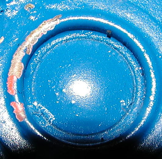

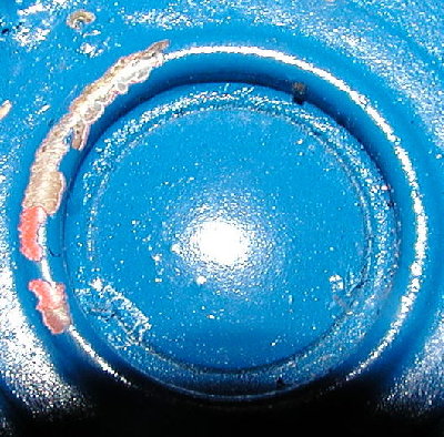

Disposable freon tanks use these, but have a section where the disk is retained instead of ejected completely. The freon tank on the inside has a flow restricting orifice, so when blown open the orifice is about 1/4 inch in diameter.
I retained this disk on my T Shirt cannon, but it's highly unlikely to pop at any of the pressures I am using.
The thin stamped ring at the edge of the disk is easy to see.
Shear disk on the T shirt launcher.  This is the original Freon tank over pressure protection device.
