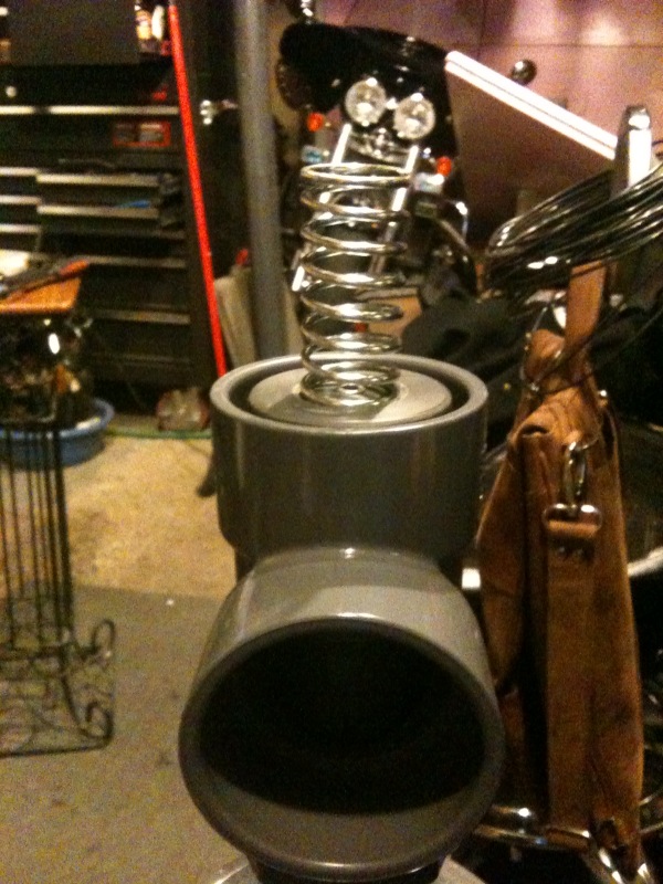

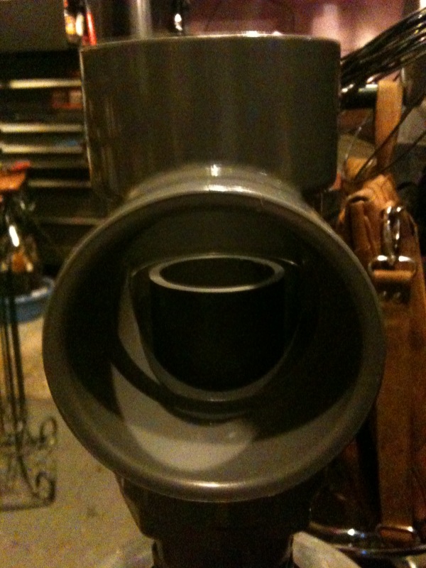

Hi from Canada , I am mulling around an idea here goes ,
I am building this into a 3" T , a piston valve held against the combustion chamber outlet with a compression spring behind it to hold the chamber @ 28 PSIG
in theory the subsequent pressure rise on ignition will overcome the spring and dump the chamber then slam shut again any thoughts ???

Are you gonna be able to dial that up??? Really you should shoot for the spring holds whatever your LAUNCH pressure is intended for, otherwise it will be surely underpowered... Is that a schedule 80 tee?

Yes can change spring pressure , just want it to hold back the 28 psig mix until the boom- the chamber is sked 80 the rest will be wrapped in fibreglass
epoxy for reinforcement have you seen this done yet ? and does it work ?

Piston hybrid have certainly been done, something like this:
The idea works, but your parts appear to be made of plastic...

A couple have done it, I'm sure someone will be by shortly with links...Or you can check the wikipage and look under cannon designs or such... The point of doing a piston hybrid is to raise the launch pressure(the psi that hits the projectile) without having to use burst discs, so you'll want your spring to hold back more than just yoour mix pressure, you'll want it to hold combustion pressure untill it reaches a given psi and then opens...

Thats an interesting design and yes the parts are plastic for now , have a metal lathe and milling machine its just easer machining plastic LOL
