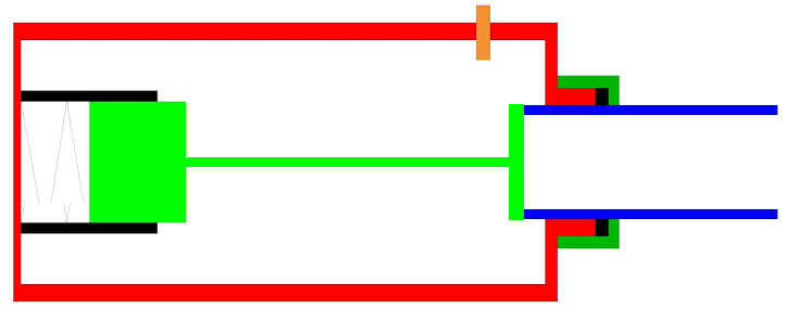

To remove the rupture disc in a hybrid I thought this:
A little on the principle of Withoutloss.
Piston spring green is stiff enough to hold the piston plated Mix until desired (30bar for example), when fired the pressure pushes the piston back and use any hand in the barrel.
A latch prevents the piston back against the barrel like that all of the pressure in the barrel
Review it!

Good idea, but the problem may be with the latch, having to reset it all the time. And why not make it into hybrid cartridges?

This isn't really new, piston hybrids have long been around and the problem you are solving with the latch can be solved instead by a spool valve opened on the piston's backstroke. Take SB15 or MrCrowley's piston hybrids for example.

It's a similar concept to SB's and MrC's pistons, but they don't use springs for a good reason. I'm waiting for Fnord to post the picture of a flattened spring.
The latch is clever too.

Every time I post this I have to go search for my posts containing the word "pancake" because I can never find the page it's on :P
But yeah, springs are bad, mmkay? In terms of practical hybrid bumpers, they rate slightly above small woodland creatures.

Another alternative is to have the projectile seal the barrel, being held in place by friction. Long thread but worth the read: http://www.spudfiles.com/forums/hybrid- ... 19504.html
The advantage is burst disk performance without having to change the disk.
The disadvantage is that you can only use hard and smooth projectiles that will take the pressure and seal adequately.

Fnord wrote:Every time I post this I have to go search for my posts containing the word "pancake" because I can never find the page it's on :P
You know how this forum has a thing about nagging people for using the right chamber material for the right pressure.
Somewhere I imagine there is a forum which will do the same thing if you ask if *random spring* will be suitable for a hybrid bumper.
The answer of "How long is a length of string" would be the first suitable answer.
Springs have to be specced for the job just like anything else.
That one for example has been way over compressed. It should have been able to absorb the bumpers energy before the coils were compacted and crushed.
Multiple springs or more complex springs can be designed to vary how much resistance the bumper meets along its travel.
For example a "light" pressure holding the piston closed but after a certain distance it meets considerably more resistance while still not crushing any coils. A combo example would be a spring plus a foam bumper with the spring providing pre-firing resistance and the foam acting as the final stage of absorbing the energy from the piston.
The space for the spring also needs to be designed correctly so that it is free to move and will provide the right compression for the spring to provide the right force.
However, it's far cheaper and easier to wodge in a few inches of closed cell foam, call it a day and replace when the foam is crushed to a pancake.
