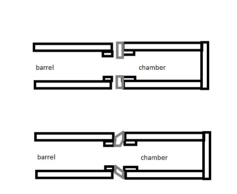

Idea #3:
Similar to the last idea, a rubber gasket flexs under pressure to seal the clearance between barrel/chamber.
[picture in attachments]
Con- Rubber exposed directly to combustion. May not be a long term option.

Assuming you don't have access to machining facilities, I'm all for idea 2. It would work a lot better though, if the insert had a fairly large diameter compared to the inside of your barrel, with a hole approximately the diameter of the barrel through it. Unlike the picture were the hole is almost the same dia. as the insert itself. This way, the air pressure and flow is keeping the breech sealed against the barrel :wink:

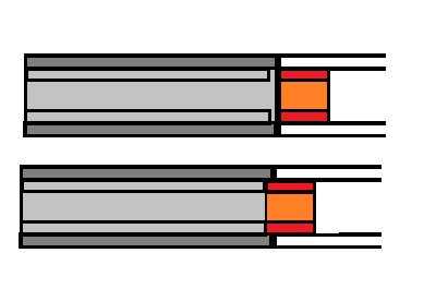

Netherlands
Posts: 3497
Wed Aug 22, 2012 3:53 pm
The gap should be as small as possible.
Then:
take two pipes , one as an outer sleeve for the barrel.
On the other side ( cilinder?) you use the smaller inner pipe to make a piston that gets blown onto the inner barrel.
Now, if the piston can cross the gap it will most likely seal better.
You could bevel the edges so when you rotate the cilinder, the piston is pushed back.
Or use a spring to return it.
ideally, barrel and piston would fit together perfectly.
You won;t need the rubber seal, just straight cut pipe and a good fit.
Something like this:
