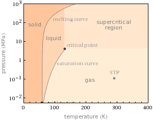

individual wrote:Ah, yes I forgot to consider that. Using hydrogen, which won't liquify until it reaches 800 BAR would be more efficient, but air liquifies at about 250 anyway.
Nah, that's well into the supercritical region for air:
