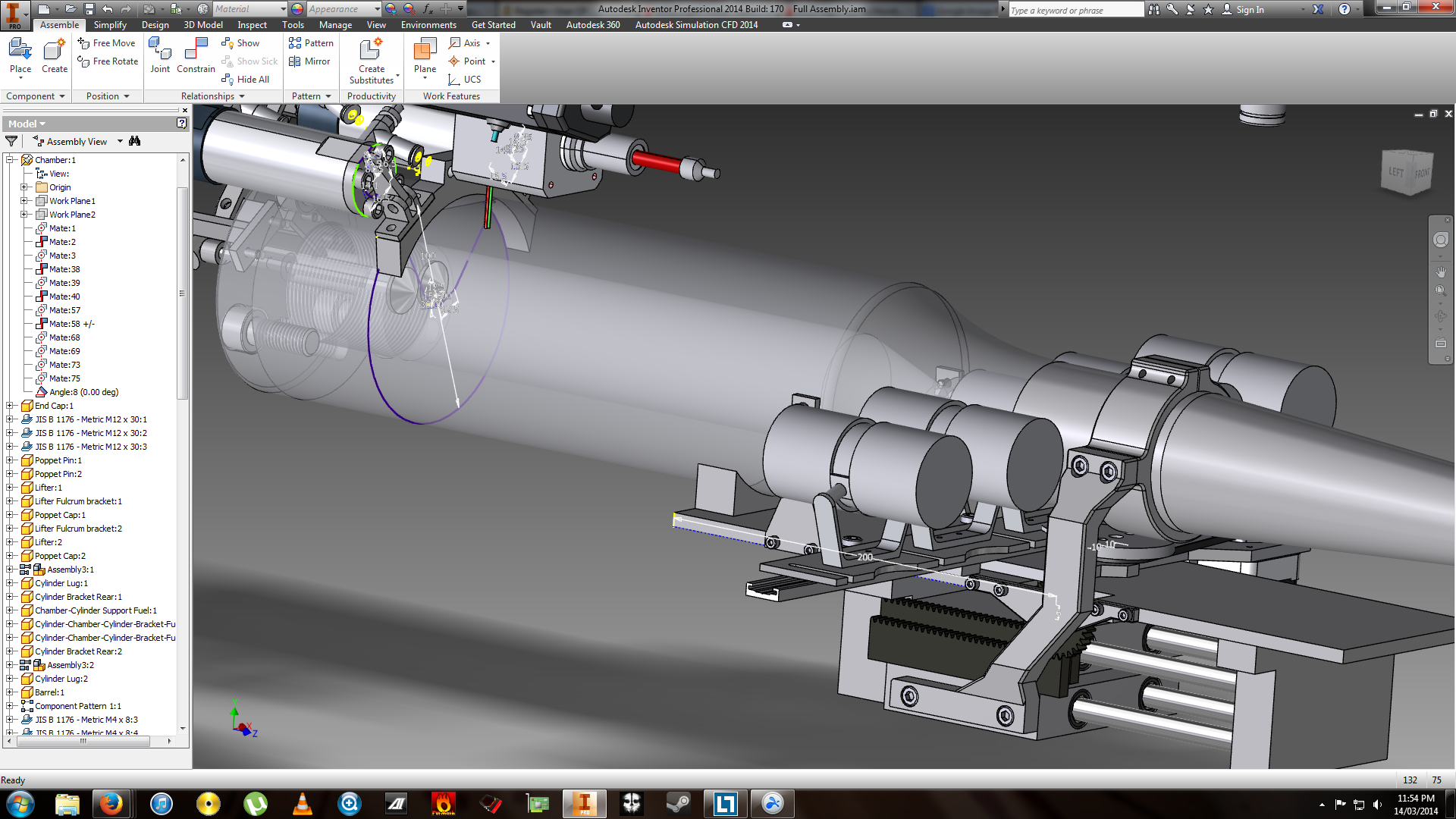

mobile chernobyl wrote:The epitome of a "hybrid", the Utron 45mm CLGG certainly proves that there is a stage at which recoil absorption becomes necessary:
I think as a community we have a while to go before we hit that point ;)
Not too far off now ;)
Pressure testing the first Popet valve
Design 1/3 for the CLGG
individual
Posts: 7
Joined: Fri Mar 14, 2014 8:25 am
Fri Mar 14, 2014 9:09 am
With your ignition, Use multiple gaps down the length of the chamber. you'll achieve a much more even burn with higher velocity and the propagation waves won't be as intense.
(I'm aware your gun doesn't reach these pressures :P )
Also, if you can find some, (assuming you're using burst discs), look up shear/tear diaphragms/discs, they attach directly to the projectile and sit on a lip on the edge of the chamber/barrel section and they break apart around the diameter so you get a consistent pressure behind the projectile, again, low propagating waves :D

individual wrote:With your ignition, Use multiple gaps down the length of the chamber...
My design does indeed have that :)
individual wrote:Also, if you can find some, (assuming you're using burst discs), look up shear/tear diaphragms/discs...
I have a good reason for not going that route (although thorough industry research was done towards using them!).
Ahh... looks like you've found the 2007 document titled "Combustion Light Gas Gun Technology Demonstration" That DYI and myself have been drooling over for the past few years - as is evident by your design as well haha!
Everything that you mention, as you'll find out as you browse this site more (seeing that you only have 3 posts...) has been discussed ad infinitum amongst the dying breed of high power members on here - but most of it was really discussed in our chat room.
Please shoot me a private message when you have a chance - it seems you are close to a design point where I was when I was developing a very similar device you are! I will be happy to discuss where our community got/was planning to go! Very glad to see an active member on here pushing the power envelope... very, very glad! :D
