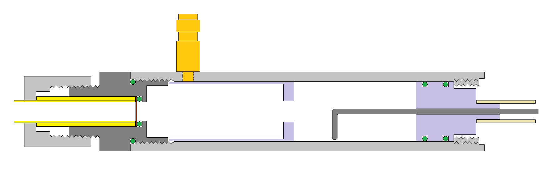

Back to the subject of this thread, for the sake of completeness here are the results of further experimentation posted in the dual chamber thread, I made a second baffle that was both shorter and with a 1/8" orifice that looks something like this to scale:
I then did some more testing again at 16x and using photo paper disks and 0.25g airsoft BBs as projectiles, this time I tested with and without baffle in the same session for a better comparison:
1) 1 disk no baffle - 1136 fps / 21 J
2) 1 disk baffle - 1851 fps / 40 J
3) 2 disk no baffle - 2071 fps / 50 J
4) 2 disk baffle - 2133 fps / 53 J
The results are similar to the previous tests. If the burst pressure is low for a given mixture, then the energy gets a very significant boost from a divided chamber, virtually double the muzzle energy in this case.
This is still lower than a single chamber with double the disk layer. Using one disk and a baffle generated just 75% of the muzzle energy achieved with two disks and no baffle.
It's worth noting that the baffle is not fixed in place and is just a tight fit, so I don't know if it's being moved around during the combustion cycle, it could be that what we are witnessing is not "pressure piling" but simply the effect of turbulence.
My conclusion based on this limited data would be that this setup might be useful with a simple combustion that wouldn't normally use a burst disk, but for hybrids there does not seem to be an advantage compared to using the optimal disk burst pressure.
