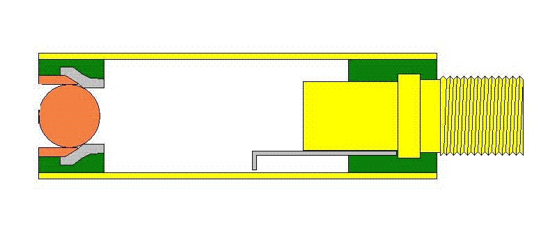

JSR: I still think the stungun is the best idea, it has the advantage of agitating the molecules in the case it doesn't ignite them. So, with the relatively high frequency of sparks, if the mix doesn't burn at first, it burns quickly after. I think your design is really good. REALLY.
Sat Apr 17, 2010 1:35 pm
POLAND_SPUD wrote:don't you think that this would be better?
Interesting idea for an auto, but too complex for a cartridge based mechanism.
I made another cartridge prototype in the meantime based on the diagram posted above, with the spark gap as small as I could manage without the wire actually touching the cartridge body, we'll see how it works with a piezo. Sadly stunguns are illegal in Epoxyland so I have no easy way of upgrading my ignition source.

Why don't you build one? On the French forum, they suggested that a Ruhmkorff coil can produce enough "juice" to spark in a hybrid. You just need a iron core, copper wire (two different sizes) and a lot of time. I don't know, maybe I could try... something like a 1:10,000 step-up ratio might be good lol

But the thing is that I want to have a working self-loading cartridge system, not a semi/auto hybrid. The advantages of using hybrid cartridges over pneumatics (assuming a friction breech is used instead of a burst disk) are several:
- lighter, simpler cartridge with more power per cubic capacity with a comparable HPA design
- no need for a strong bolt spring to hammer a pilot valve open, making the possibility of a self-ejecting cartridge more realistic
I seem to be getting good internal spark with my latest prototype, I'll give it a go tomorrow. I'm not happy with the centering of the breech, so I hope it works but blows up :D
