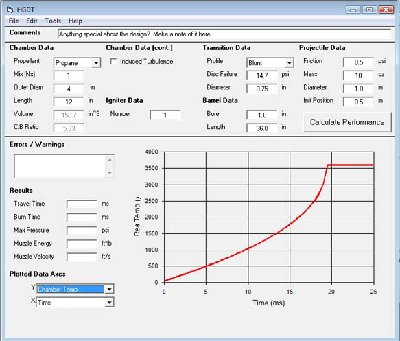

I've been doing some reading on propane flame propogation rate.
On his website Jimmy101 has some experimental data (sort of) as well as an equation that I presume corresponds to *initial* flame rate in quiescent conditions.
I've also done other reading in other areas(*), but I've never seen much treatment of closed vessels and flame rate progressions that are anything other than empirical.
In other words.... Does anybody have any ideas as to a set of assumptions/equations to model combustion for our purposes? It doesn't have to be perfect, mind you, just reasonable. I know there are a zillion variables, but ya gotta start somewhere, yada yada yada.
Now, to inspire ya'll, the reason I'm asking.... see pic.

OK.... With nobody answering as yet (so I'm impatient!).
Thoughts....
Initial burn rate can be obtained via the equation on Jimmy's webpage (forgive me for not remembering it).
At 15.7:1 compression ratio, burn rate can be assumed to be sonic at 540 C (813 K).
Between those two points.... I'm thinking a 2nd order polynomial with a 1st order negation. IE, Rate = a + b*P^2
This would have to be calculated on the fly, but that shouldn't be a big deal.
Thoughts....

Interesting reading. I can see that you and I have gone over much of the same ground and apparently we went over it almost at the same time (that screen capture I posted? 90% of that code was written in Nov '06). Looks like my big oversite so far is that I was/am still modeling an adiabatic system although I've not made it to the point of actual projectile motion.
Also very interesting to see your simplified combustion assumptions. And here I've been trying to come up with some sort of "transition to turbulence" model that scales worth a damn (and failing miserably at it, I might add!).
So is there any more of your lecture series?

Ya, that is about where I kind of got stumped. With a little real gun data I could deal with the heat loss problem (though how well I'm not sure).D_Hall wrote:Also very interesting to see your simplified combustion assumptions. And here I've been trying to come up with some sort of "transition to turbulence" model that scales worth a damn (and failing miserably at it, I might add!).
It is the transition from a laminar to turbulent flame front that finally stopped me. In my model, to match my "standard gun", I have to start with a laminar speed about twice as fast as it should be (0.8m/s vs. 0.4m/s) and use that faster initial speed to grossly account for the faster flame front when turbulent. Overall not a bad approach and it may be possible to tweak the correction further if there is sufficient real world data. I figured that what happens during the laminar phase is a pretty minor part of the total combustion process, the interesting part is the high speed (turbulent) combustion phase so you might as well just model that.
That is why I posted earlier about the possible coupling between the combustion process and the projectile's movement. Inital thoughts would suggest that once the projectile starts to move the temp and pressure drops and the combustion process slows down. (In most combustion guns the ammo starts to move when a fairly small, 10~30%, amount of the fuel has been burned.) However, if the movement of the ammo causes sufficient movement of the gases then the laminar to turbulent transition may more than make up for the affect of dropping Temp.
I've wondered if this kind of an affect might be part of the explanation of the "0.8 CB ratio rule". The chamber volume and the barrel volume plus the projectile's movement are all working togther to give the burn speed. An oversized barrel doesn't have enough fuel left when the gas velocities cause the laminar to turbulent transition. An undersized barrel causes the ammo to exit before the transition can occur. The optimum gun balances all these affects.
I wonder if you could use a Reynold's type calculation, along with the flame speed and gas movement speed, to get a rough estimate of laminar to turbulent timing. Something along the line of "If flow through the system at the flame front location is turbulent (by Reynold's number) then multiply the calculated laminar speed for the current Temp & Pressure conditions by 5X~10X (or whatever seems suitable)".

Yeah, I've been toying with the Reynold's number idea. Figured a cheap and dirty way to deal with that might be simply adding 1 to the burn rate exponent or something when it's decided that the flow has gone turbulent.
And I must confess that I'm somewhat at a disadvantage here. My combustion studies have always centered around solid rocket motors. In rocket motors, the burn rate is dominated by pressure; not temperature as your stated models indicate. It took me a bit to wrap my head around that one but I think I understand why the mechanism is different now.
That said... I'm a bit confused by your equation. You indicate flame rate as being dependent upon temperature.... But WHAT temperature. The adiabatic flame temperature is obviously not the right temp to use as to do so would result in a step function increase that doesn't make much sense in the real world. I tried using the unburned gas temperature (assuming it's being heated by adiabatic compression throughout the burn), but it doesn't seem to accelerate nearly fast enough with that approach. Are you using the bulk average temperature?

Well, the good news for the Pipe Dream is that virtually any flow is going to be turbulent. The bad news for folks around here is that with a 2" diameter it looks like the flow goes turbulent at about 0.75 m/s so clearly there WILL be a transition for smaller systems.

Sorry to sidetrack the discussion of the model, but I'm not so sure the projectile starts to move early on in the launch sequence...
Initial accelerations in combustion launchers is HIGH.
<a href="http://img.photobucket.com/albums/v611/ ... s.png">Old graph</a>
Ignore the pink line, the "14ms", and the error bars - respectively, those are a model, a time estimate, and made up.
This might explain why fans <i>only</i> improve performance as much as they do. Which sometimes seems small, considering the long list of benefits they provide - some of those benefits are irrelevant.

Well, your "HIGH" is a relative term. Looking at the pink line on the graph (and assuming I'm reading it correctly) the projectile starts to move at about 50 PSI. That corresponds to about 50/120 = 42% combustion. So, when is "early"? Certainly 10% would be earlier, and 90% would be late, but ~40% is in the range where movement of the ammo will affect the burning of more than half the fuel. I would think that could be significant and qualifies as "early".boilingleadbath wrote:Sorry to sidetrack the discussion of the model, but I'm not so sure the projectile starts to move early on in the launch sequence...

Isn't the estimate of the pressure at the start of ammo movement basically a measure of the static friction in the system? Or perhaps it would be the difference beteeen the static and dynamic friction.
