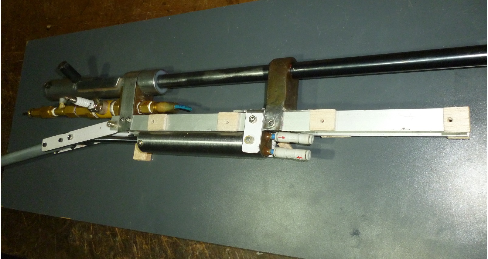

This is a project called "Armadas 1500 II". It is a weapon that works with an integrated air pump, it is a single shot, hybrid that precompresses at 8X - 10X.
The firing barrel is with 12 microgrooves, caliber .25 and fires common pellets. The inverted bolt is made of 1045 steel, the combustion chamber is approximately 20 ml. It has quite a bit of punch, going through 4 cans cleanly at 8X, with only 4 pumps.
It is an evolution of the previous ones, because it has more performance, 4 or 5 pumps are enough to compress the mixture and fire.
The dosing system is the standard one that I designed, and it works very well. Accuracy is excellent.

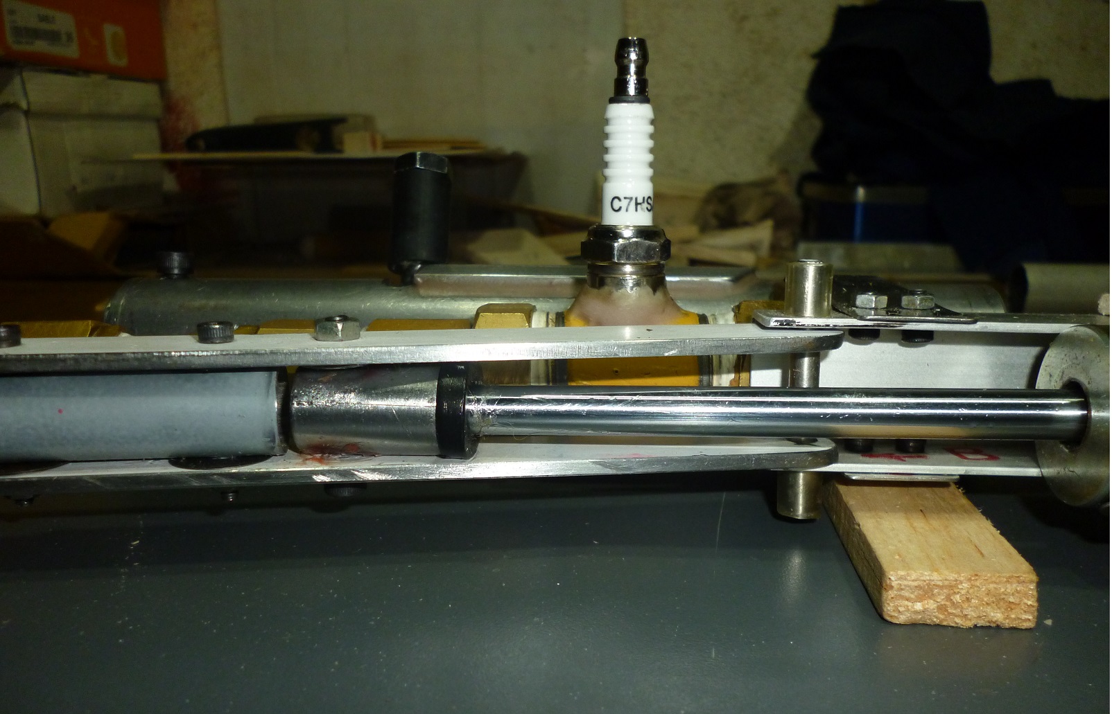

I used a motorcycle spark plug, screwed into the combustion chamber which makes it fire safely. The lighter is piezoelectric from the big ones.
The main valve is of the o'ring and ball type, which works excellent (it is the "captive ball" valve). The o-ring lasts about 150 - 180 shots before being replaced, which is easy, without having to remove too much.
The front tube houses the small liquid butane gas tank, and has its manually operated valve (pressed with the finger), to introduce the gas to the dosing system, about 6ml.
The sequence of operation is simple: You close the valve, place the pellets in the chamber, introduce the butane and give 4 pumps. The pumping lever, in this case the rear, includes the shoulder rest.
The ball valve - o'ring, is closed by pressing the small stem that can be seen on the back of the gun.

That is really clean and very nice. I love that it's a hybrid. So awesome. Nice job!

Sick! Looks very well put together. Inspiring actually!

Very clean work, nice "proper" evolution after all that prototyping...
I like the markings too, although perhaps it's more of a Fuerza Aerea (+Butanea) Argentina sort of equipment :D

Is it my impression or did you use balsa wood in the construction?
You can always tell when a spudder is also interested in model aircraft :D
Re: Hybrid pumped weapon project
Posted: Thu Jun 16, 2022 9:33 am
by hectmarr
Not in this case because the gun is a bit heavy about 3.4kg... I used 3mm tri-ply wood with a layer of thin fiberglass on the inner side, and screwed to the metal. In other models yes, I have used hard balsa because the weapon is very light.
