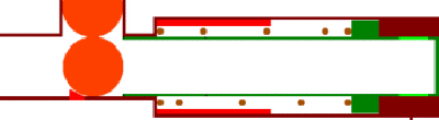

I've been thinking about the design and perhaps it would be best to use a compression spring to return the bolt, as this configuration would be easier t otune - this would make it practically identical to the breech clide used in his GB semi, so much so that I can adapt his animation of the said launcher to illustrate what I had in mind:

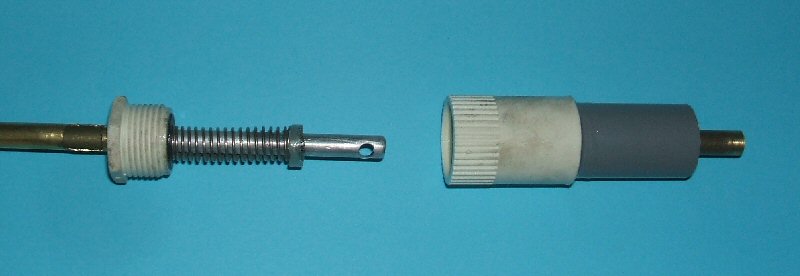

rear section removed, with bolt held in "rest" position by spring

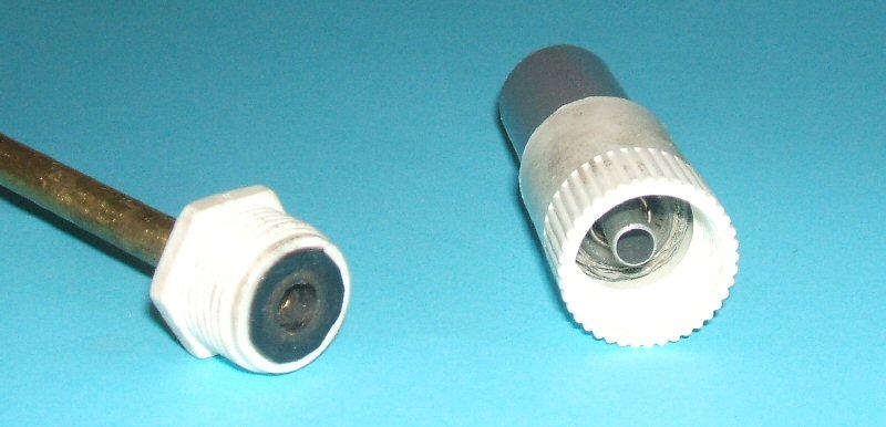

end view of the two sections, with the bolt and spring in the rear section

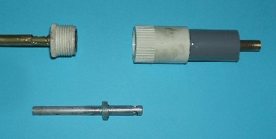

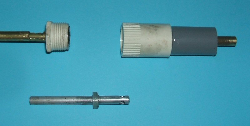

Prototype in disassembled form, from left to right barrel section with ammunition feed slot and rubber damper in male thread, bolt section with cast epoxy stopper and rear section with brass tube air feed that also doubles as a bolt housing
