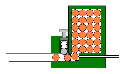

Would the esteemed gentlemen of the board find something like this for 0.177" BBs more agreeable? The mag is 1 BB wide, housed within a 3/4" tube that also serves as a chamber.
Thu May 21, 2009 10:56 am
or you can use a hop up unit... or something that works in a similar way
have a look at Subsonic Spuds' gun and its loading mech... this could help to lower ROF as there is no need to provide a lot of air to the chamber since BBs don't have to be agitated
EDIT
of course you would have to put the detent as close the the T as possible - in order to avoid double feeds
hhmm.. This second one looks a little more doable.

Thu May 21, 2009 2:58 pm
POLAND_SPUD wrote:or you can use a hop up unit... or something that works in a similar way
I want something that can hold the projectile to close to 500 psi so which mostly precludes the use of an existing commercial unit.
That's one of the design solutions I'm considering, either with a single stack magazine parallel to the barrel to retain compactness or a multi-row magazine tangential to the barrel as used in the Suomi submachinegun detailed in this patent: http://www.google.com/patents?id=4j5bAA ... dq=2217848

Thu May 21, 2009 6:18 pm
I think that if you want to do this custom ammo is the way.I don't believe you need perfect airtightness, just higher inlet than leakage, but still enough to drop flow enough to allow another round into the breech.
I think a good ammo for this would be to use telescoping tube for the barrel, then get the next (lower) size. Cast some of whatever (a glue) into the pipe, chop it into whatever lengths with a razor saw and mitre box, then a quick pass with a belt sander to finish them off. Or you could just use rod..
Thu May 21, 2009 11:47 pm
inonickname wrote:I think that if you want to do this custom ammo is the way. I don't believe you need perfect airtightness, just higher inlet than leakage, but still enough to drop flow enough to allow another round into the breech.
Indeed, it would work without a seal in most cases. The thing is that for the small chambers, you'd probably need tiny flow for pop-pop-pop sort of firing so if you want a low rate of fire, the seal would need to be included.
This is pretty much what Hotwired was talking about, however as I said for various reasons not worth it in my book.
Or you could just use rod...

Fri May 22, 2009 1:54 pm
I dont think this is a feasible idea. Your ammo will have to seal very well if you want to have a low ROF, and then the loading mechanism isnt very promising.
I'd call this a modification to a detent vortex.

Thu Oct 01, 2009 6:06 pm
I think this is a great concept, it should give you more efficiency per shot over a traditional auto like a blow forward bolt, while actually being simpler. But you know that already off course.
If you have a lathe it shouldn't be too difficult to make a bunch of custom cylindrical projectiles with an o-ring groove, perhaps at the tail. Just don't lose them when you shoot.
And if you use a spring-loaded detent the advantages are huge. You can adjust spring tension to control firing pressure (and ROF since you can repressurize to a lower pressure faster). But you can also attach a trigger system where you either manually release the detent for semi-auto, or hold down the trigger to allow the spring-loaded detent to cycle for full auto.
The main issue is I think that there will be problems with getting the feed right. Unwanted feeds could be a big problem, with the next round feeding in right after the first one moves out of the way but isn't very far down the barrel, choking off flow. But some fiddling should get it right I think.
Also, to hold a stack of cylinders you're gonna need a rectangular pressure-tight magazine. How is that gonna work?

Thu Oct 01, 2009 6:19 pm
yeah... the idea is pretty cool... I don't see much sense in adding o-ring to each projectile really as you can put them on the launcher...
if you could build a prototype that feeds reliably you've got an ultimate gun/holy grail of pneumatic launchers...
lol it's that simple... no launcher could offer such a good performance as this, which is why I think it's not possible to build one that would work all right (if it was then every one, from airgun to paintball manufacturers, would be already using this design)

Fri Oct 02, 2009 1:38 am
skyjive wrote:Also, to hold a stack of cylinders you're gonna need a rectangular pressure-tight magazine. How is that gonna work?
There are few problems in life that cannot be solved by the judicious application of the appropriate amount of industrial strength epoxy adhesive ;)
In some ways, the "BV unit" used in some airsoft guns uses this system, incorporating a reciprocating bolt to aid with feeding.

Fri Oct 02, 2009 6:55 pm
I think it can work, but with cylindrical slugs, as I see the advancing pellet's skirt catching on the head of the next one in line.
Cylindrical shaped slugs (for instance .22 LR slugs) & coating each one with Moly lube would make everything move & seal nicely.

Sat Oct 03, 2009 2:23 am
jaythedogg wrote:I think it can work, but with cylindrical slugs, as I see the advancing pellet's skirt catching on the head of the next one in line.
With slugs like that you'd need a rifled barrel, things start to get complicated. Also, lead slugs are hardly reusable, and with an auto you go through a lot of ammunition. This is why I went for 3/8" bearings, though I have to admit they're not as hard as I thought. I have a couple which impacted on a hard surfact that are significantly deformed, if I had enough battery for the macro setting on my camera to work properly I would post pics :roll: :D
