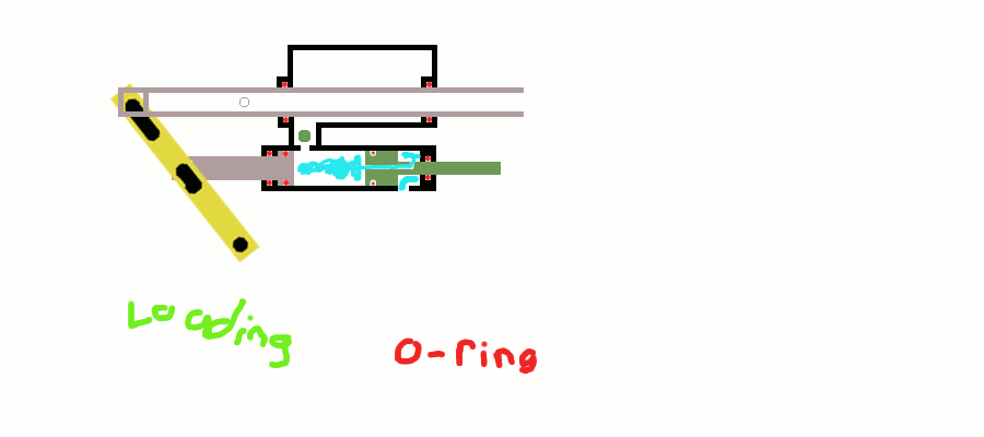

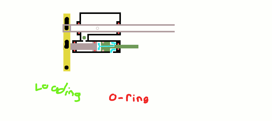

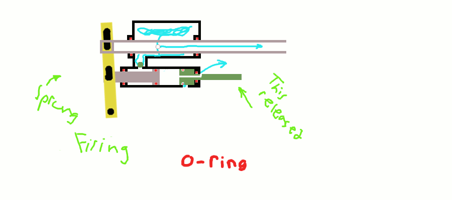

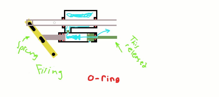

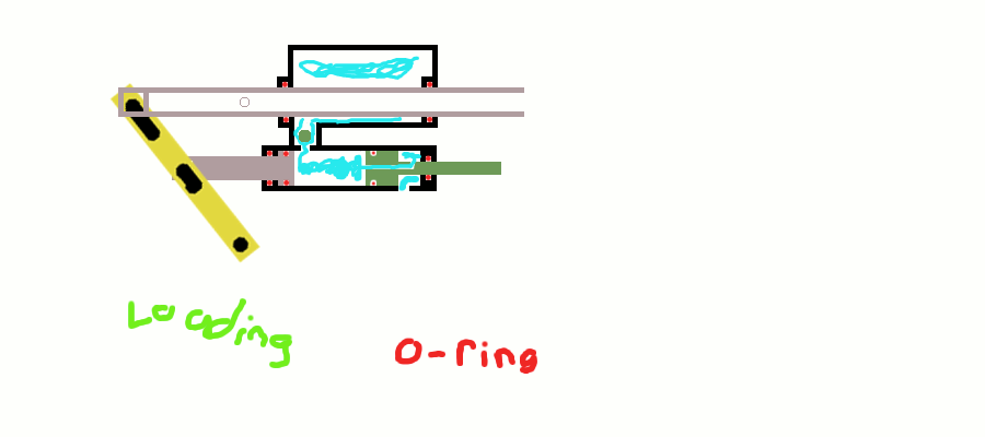

I was thinking about a pneumatic revolver (pistol) and came up with a quick valve design I think the picture explain it. Spudfiles pictures don't work for me though, so I can't tell if it uploaded properly.
Basically, the air pushes back the ram at the bottom, moving back the bolt at the top, until the top chamber is filled. Then the ram is vented, the one way valve keeps the chamber full and the bolt movves forward and vents the chamber.
Any glaring problems I've missed or better ways of doing it?

Sun May 09, 2010 8:18 am
I posted some of the frames, hope it helps.
