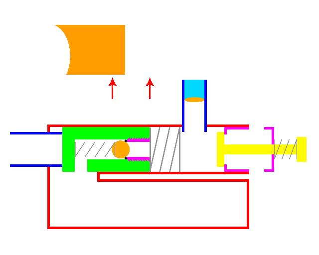

I want to make a small(ish) semi auto QEV, that requires relatively little fabrication, for use with <45psi
I plan to use a Palmers CO2 cartridge regulator http://www.palmer-pursuit.com/cart/inde ... cts_id=618 for my source.
I want to be able to cycle the shots fairly quickly, so I figured a check valve filled from the pilot side. I think the bolt should be easy to do, just a hole down the middle and a partial thread for a grub screw, then another hole in the side.
Heres what Ive come up with so far
...this is for a nerf maverick :lol:

It looks like a really nice valve setup and that would give you bolt-action yes?

in place of the two fill/pilot valves you use a three way valve
Sun Oct 24, 2010 5:52 am
yes, my padawan is right :wink:
Check these guns - they all use the same design:
http://www.spudfiles.com/forums/i-too-h ... 21039.html
http://www.spudfiles.com/forums/semiaut ... 20259.html
http://www.spudfiles.com/forums/semi-au ... 21799.html

lozz08, its not bolt action, I just used bad terminology, I was referring to the piston.
Cheers for the advice on the 3-way, I hadnt yet thought about what to use there. Had some trouble finding something appropriate untill I came across clippards range of miniature valves http://www.clippard.com/catalog/Page%20110.pdf Im looking at the J-series spool valve.

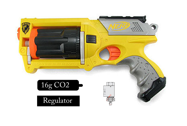

scale reference to the blaster to be modded:

yeap, that's the right valve (MJVO-3)
