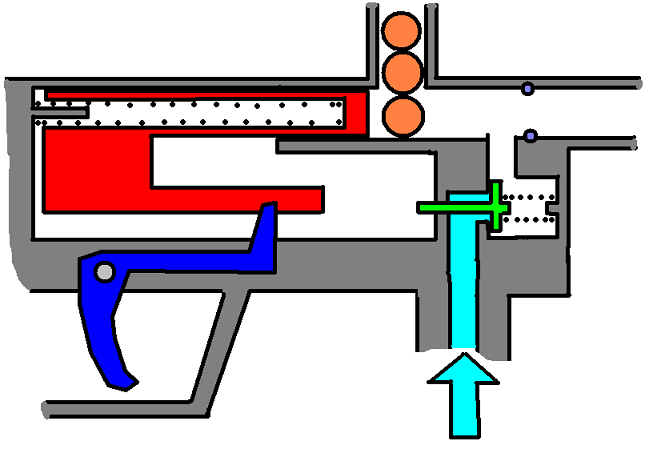

So essentially is is a pop-off valve, hmm I see your point.
Now I come to mention it I think there might be some possibilities emerging from a blow back design... but there will be quite a few unforeseen problems that will emerge... I will look into it. :D
Update: jsr (and others) this is a new idea I came up with, I saw an idea like this somewhere on this site (a link would be much appreciated) and thought if i could make some kind of a bolt that is blown-back by the air, the same air which fires the bb.
this idea combines the pop-off and blow back bolt designs (where the bb is "pop-ed" off by the charging air. and the bolt is "blown back" by the same air)
any ideas or thoughts are welcome.

It looks like it could be made to work, with a spring driven bolt held by a trigger sear. How would you build it in terms of materials? It's fleshing out the design that's usually half the effort.

Here's an alternative configuration (can you tell I'm using a laptop with a flipping touch pad...) but really it's getting too complex, this would be easier to make.

Now (looking at your above picture) we are getting into the realm of paintball guns, *a more simple version of this idea is used in a multitude of tippmann markers (and various other markers) I have even seen air rifles use this firing mechanism http://air-ordnance.com/index.php?osCsi ... 536135712c
I am thinking whether as to actually make a scaled down valve system like the tippmann paintball gun one, as it is a tried and tested valve system. I will then beef it up and make a spring loaded mag for it and attach it to a waist mounted remote tank, so as the tank size will not alter the maneuverability of my gun.

cammyd32 wrote:Now (looking at your above picture) we are getting into the realm of paintball guns
... meaning things have already gotten too complex. If you're using hard spherical projectiles, you can use a detent and low-flow valve to make a more powerful and less complex launcher.
