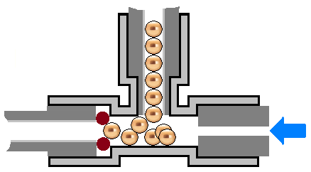

Proportions are important
Incorrect, the T fitting i am using is 1/4" NPT. The BBs fit perfectly, without any modification.
you should go up to 3/8 or 1/2'' to alow air to flow around the bb behind the one stuck in the dent.
I will have a look at the T piece, as it may be that only one BB can fit in the 'chamber' with none behind it. It is an amazingly tight fit, almost like it was made for it.
