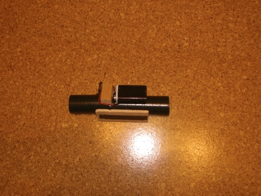

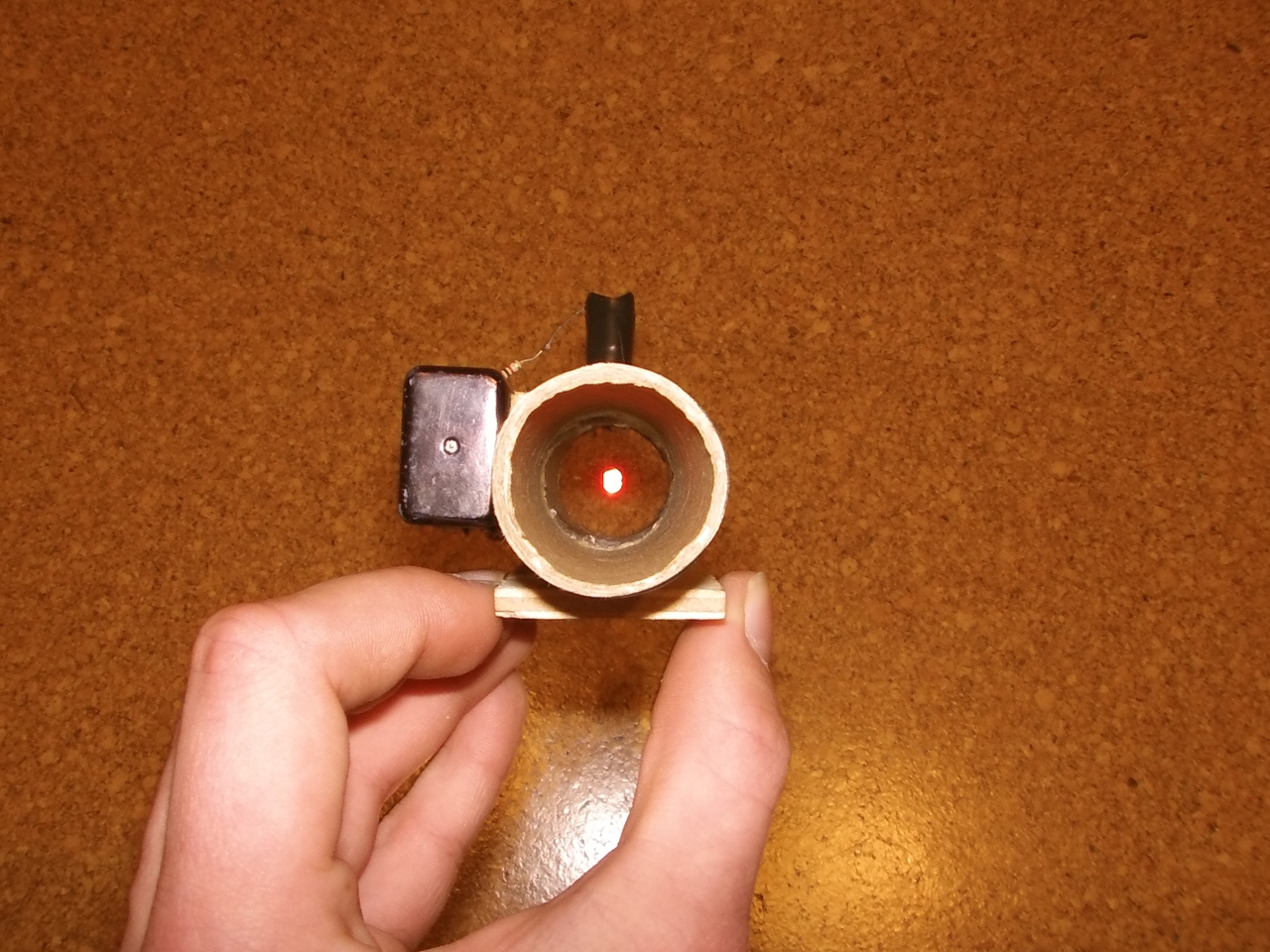

just wanted to show you the red dot sight i made for my Airsoft Sniper rifle. First of all, it is completely pointless because it generates just a fix point.

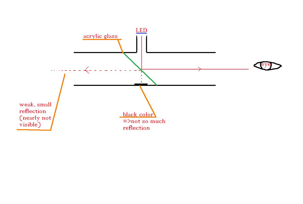

It's got a red LED mounted on top of a 45° angeled agryllic glass, that reflexes the point right in the eye of the "marksman".
The red dot can't be seen from the front=)
Because it creates a fix-point, the marksmans eye works as the second point needed for accurate aiming. It's just for cool looking.
/watch?v=1HP0hhGxluE
That's the Video i uploaded about it
If you've any comments, questions, tips, please post=)

If you get really good and gently curve the plexiglass either from sanding and polishing or heat shaping, you can change the virtual image distance of the dot to near your target distance instead of appearing way in front of the target just a few inches from the viewer. Put a sheet of plexiglass on a metal bowl in the oven and heat till it sags slightly. Experiment till you get the right curve.
Another option is to place a lens between the LED and the plexiglass to place it's virtual image near 25 yards. Either method works well. This latter method reduces parallax errors.
The current configuration provides large errors if the eye is not dead center just like using open sights without the rear sight. The two sights are only accurate when sighted in line with both.

To add to what Tech said... IIRC, the proper shape for the reflector/lens/whateveryouwannacallit is hyperbolic.

yep, i know. But i don't think i can create such an good and even lense^^
yes, with a collimator lense it would work..like in my "real" red dot i'Ve got.. but hard to make by yourself..
The idea with the metal bowl is cool=) thanks, maybe i'll try sometime
