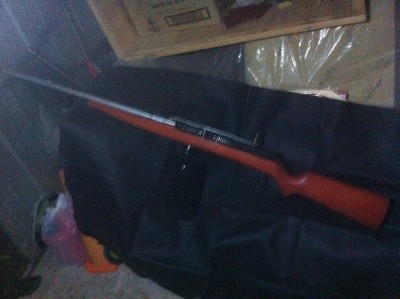

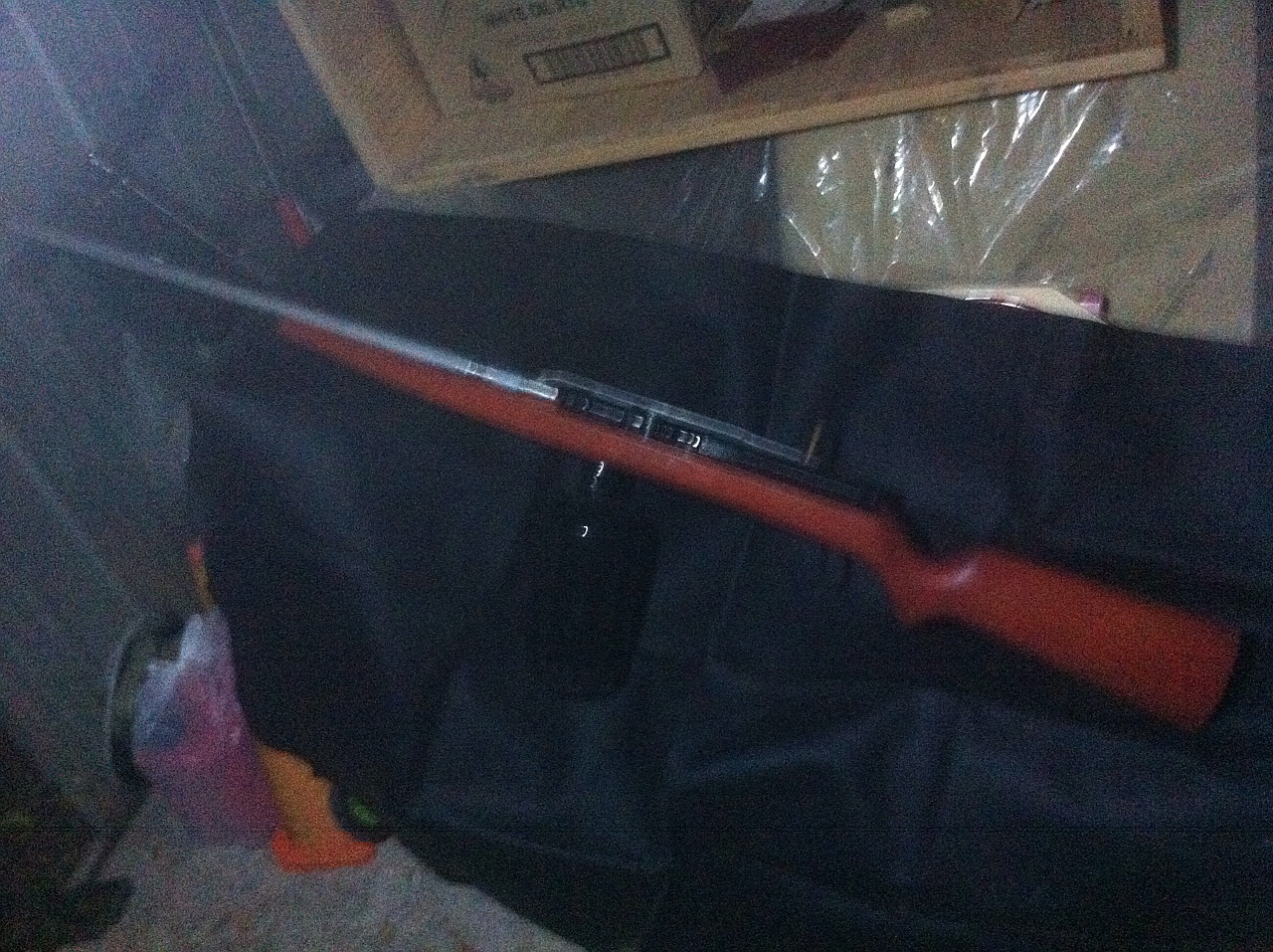

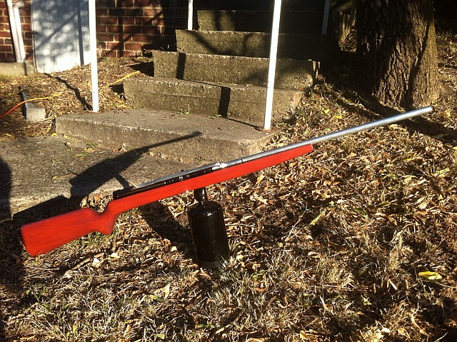

6mm single shot almost finished
andrew67
Australia
Posts: 48
Joined: Sat Apr 27, 2013 9:57 am
Wed Mar 05, 2014 6:25 am

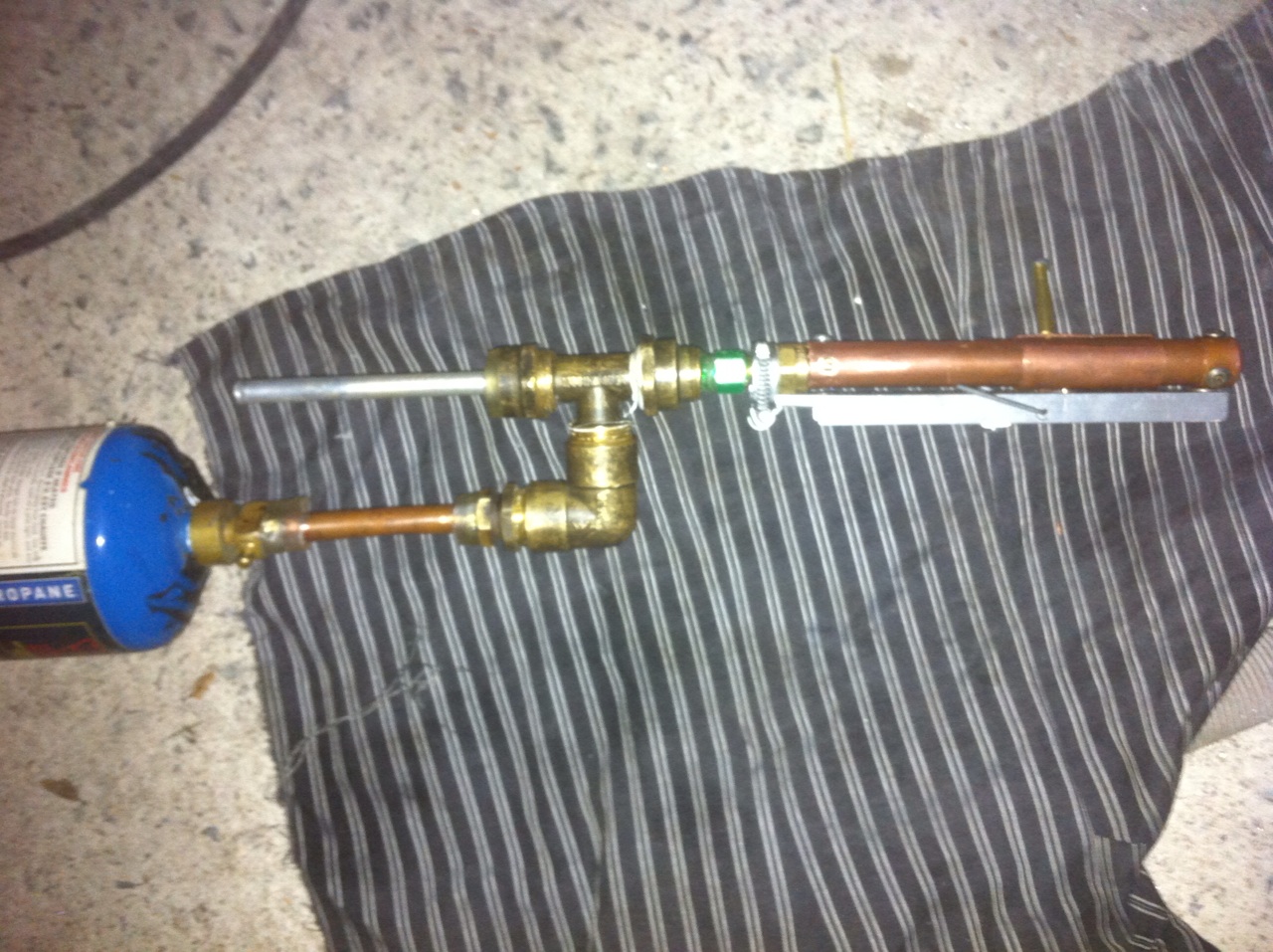

20mm t piece(home made QEV)
20mm/12mm epoxy piston
6mm/56cm barrel
modified air hose coupling(pilot valve)
20/100mm copper tube,housing the sprung piston for the trigger mechanism

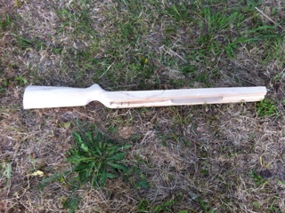

86cm timber rifle stock
approx 400g benzomatic propane tank(air supply tank)
At an approximate 120-160psi it fires 6mm plastic pellets consistently accurate over an estimated 10meters,using 6mm lead pellets approximately 20meters accurately but with more pressure a gauge and better ammo I'd expect a much better result.

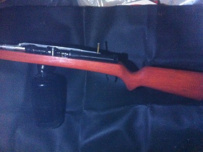

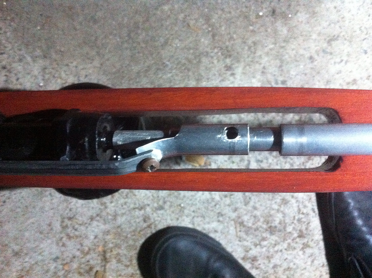

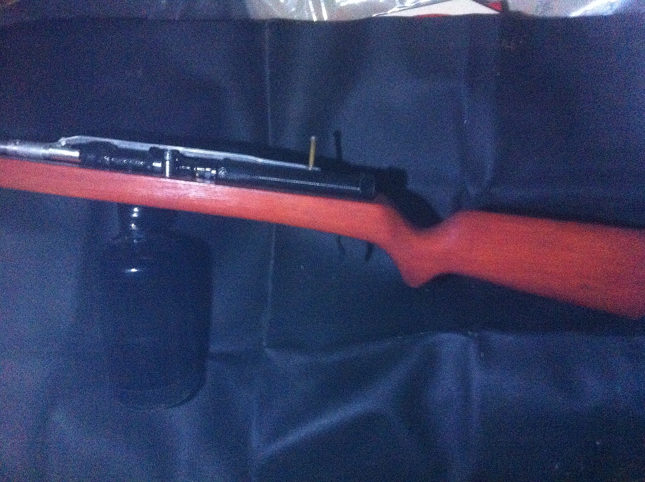

In the cocked position

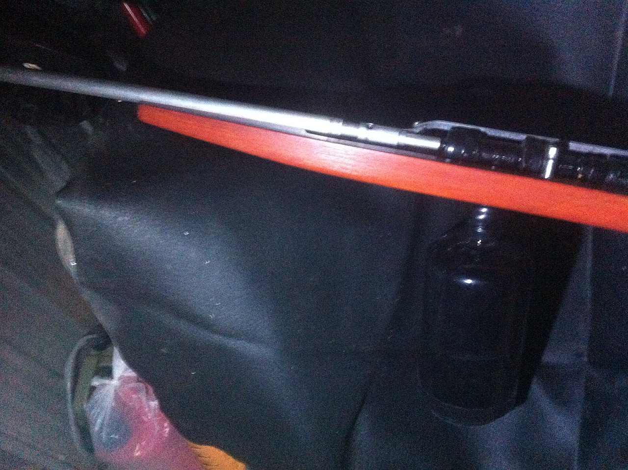

In the fired position,as it's fired there's two O-rings to keep the loading chamber sealed from escaping air.

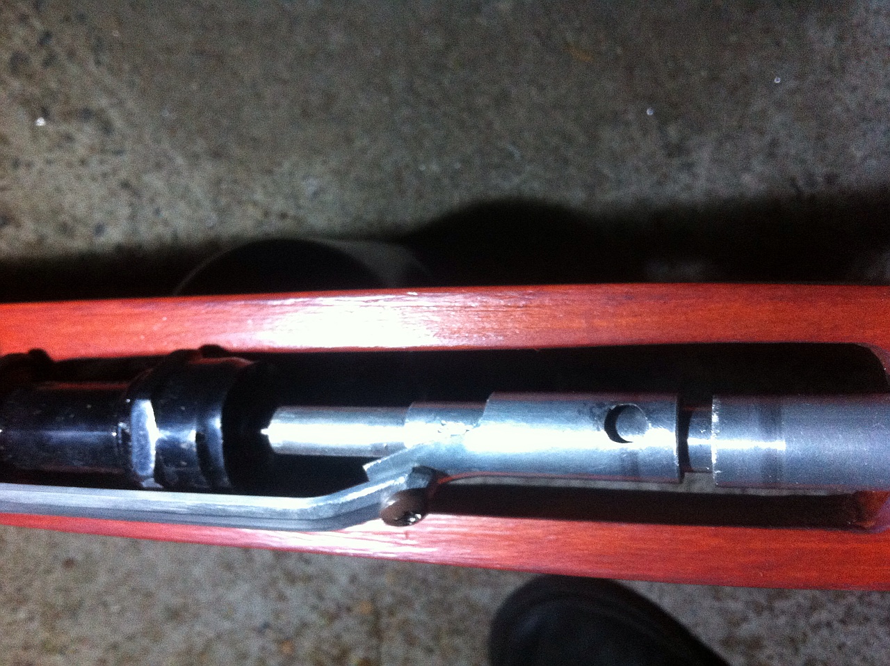

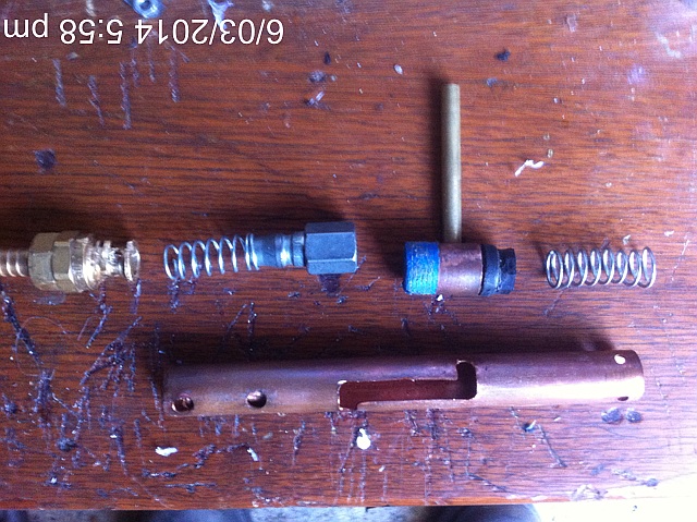

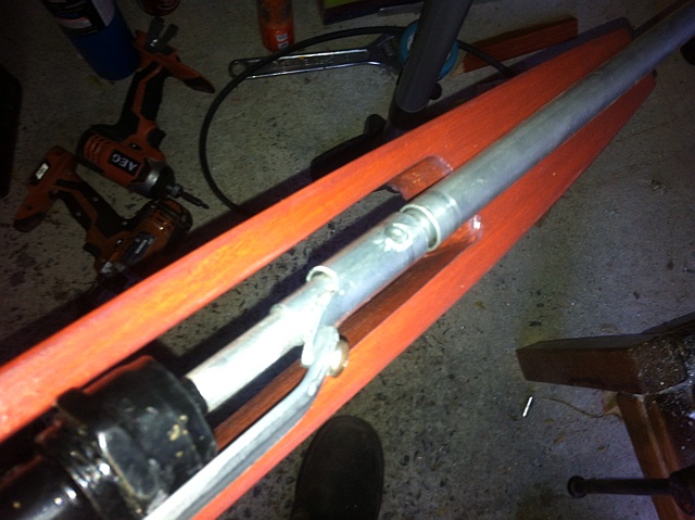

This is the inside of the pilot mechanism,it's the first one I used but it was sloppy and weak so kept the same concept but used heavier material,reasonably simple drag the copper piston back and slide the lever over in the slot you can see in the half inch copper tube (as the mechanism fits inside that)
To fire,flick the the lever out of the slot the piston then slams the male air line fitting into the female fitting releasing enough air to fire the QEV.
On the finished rifle there is no slot to slide the lever into,instead there is a small hole for a sprung screw for the piston to catch on when pulled back the screw is attached to a lever so when the lever is pushed the screw comes out of the hole and releases the piston.
The lock and release mechanism is inside the aluminium piece that's hose clamped to the pilot mechanism (first photo)
Hope you understood all that?
