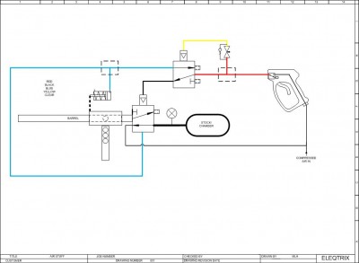

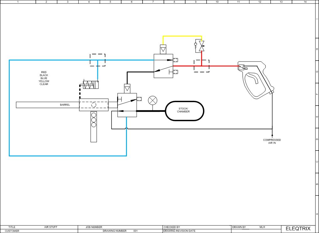

Worked on the circuit a bit, going to get some parts and make a test set up of this.
Pulling trigger should operate main valve then operate the control valve after a short time set by restrictor, which shuts off main valve and opens breach to load 1 ball. Releasing trigger should reset valves ready to fire again.
On initial loading, before firing, 1st round can be loaded manually as breach cylinder is spring return, just like a real gun.

Tried it on Fluid Sim and it seems to work :shock:

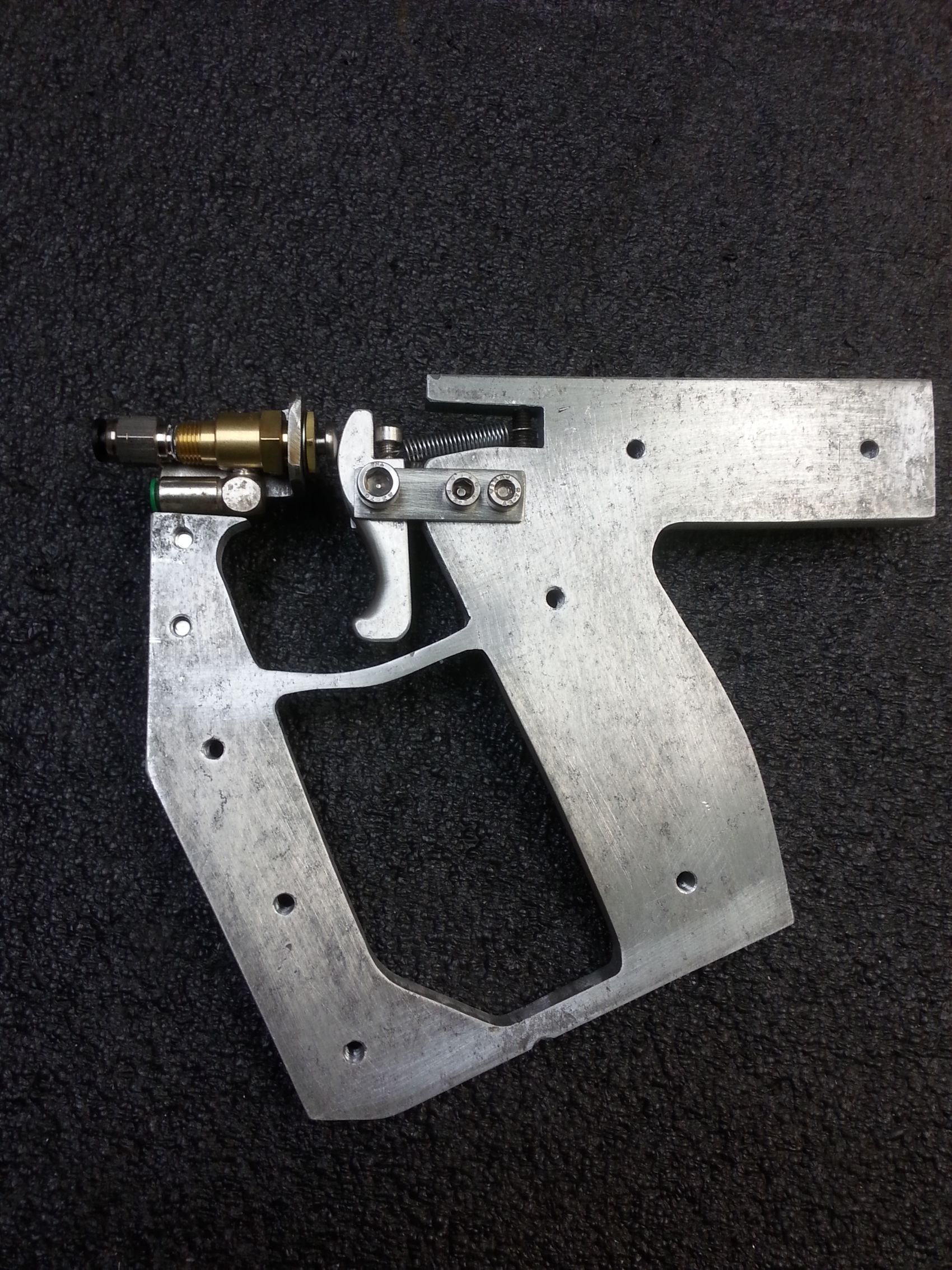

Made the skeleton for the grip and trigger mechanism

Kensingt0n
Posts: 19
Joined: Thu Oct 29, 2015 6:02 am
Tue Jun 28, 2016 4:00 am
Nice work farcticox, looks like some clean work dude.
What tools did you use to make that whole mechanism?
farcticox1
Posts: 1081
Has thanked: 69 times
Been thanked: 96 times
Tue Jun 28, 2016 4:18 pm
I have access to a decent drill press at work, apart from that all hand tools. The main plate is 10mm aluminum, it's a bit discolored as it was basically scrap metal left outside.
I have some nice 3/8 thick white nylon to finish the grip, other parts have arrived so lots more to do yet. The barrel is going to be 1/2' OD stainless seamless tubeing, the ID is 10.2mm so the ammo will be 10mm ball bearings.

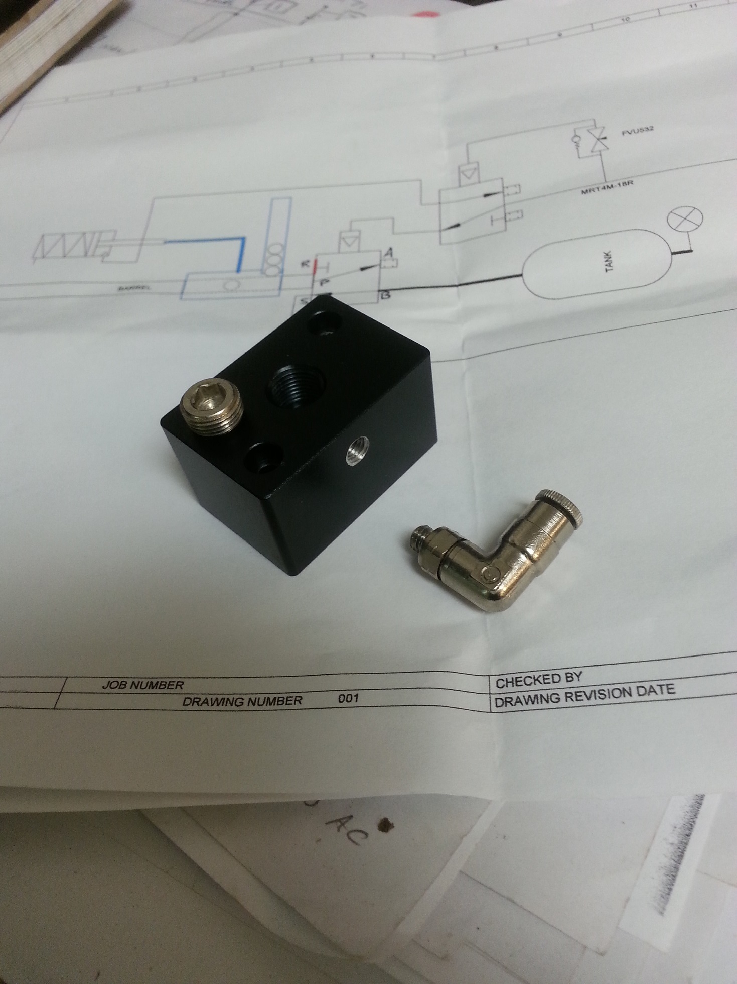

Wed Jun 29, 2016 3:42 pm
Just using off the shelf pilot air valves, I have a 3/8 port for the barrel and a 1/8 port for the pilot.

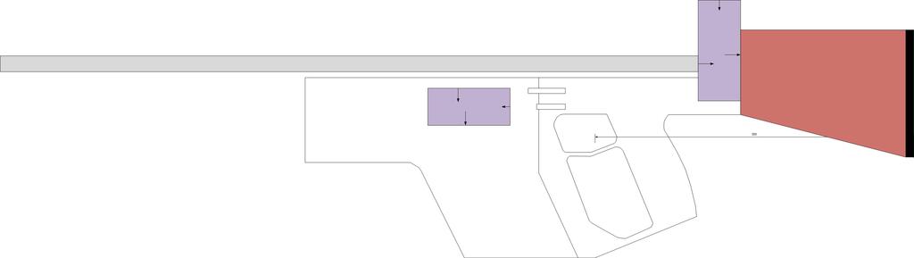

Just playing with layout, this looks interesting, the stock will be the main chamber. So what is a good chamber/barrel volume?
I have read 4:1, I should be able to achieve that easily.

I might fabricate it from stainless sheet if I need to get the volume, have Tig welder as well, or use tubing, haven't got that far yet.
Converted my main valve pilot to side entry pilot, found a nice 1/8' flush plug to fill the original hole, new hole is M5
