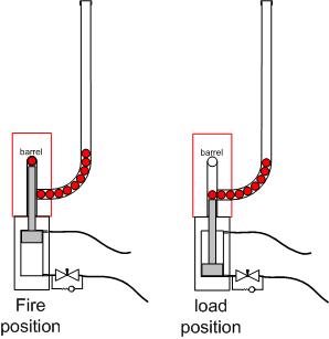

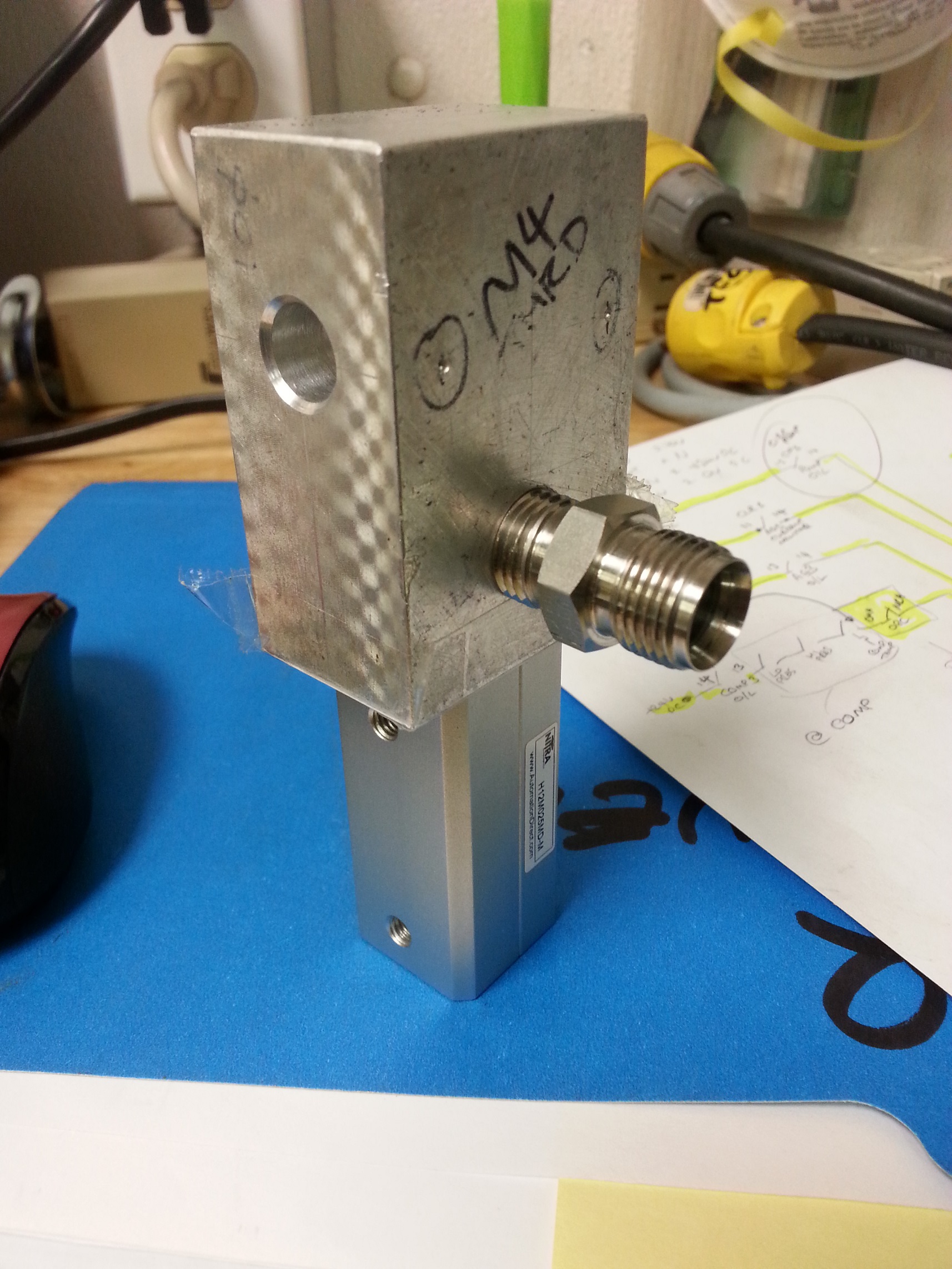

This is how this one of mine works, the pneumatics got a bit complicated though :shock:
self loading block piston.jpg (11.29 KiB) Viewed 5675 times
air lines 3.jpg (25.5 KiB) Viewed 5675 times

farcticox1 wrote:This is how this one of mine works, the pneumatics got a bit complicated though :shock:
It is very logical the system that F1 uses. :) I use them in a similar way but I block the ammunition that goes in with the one that comes out so that two do not enter. Otherwise, if the measure is very fair, sometimes the ammunition entry is blocked.

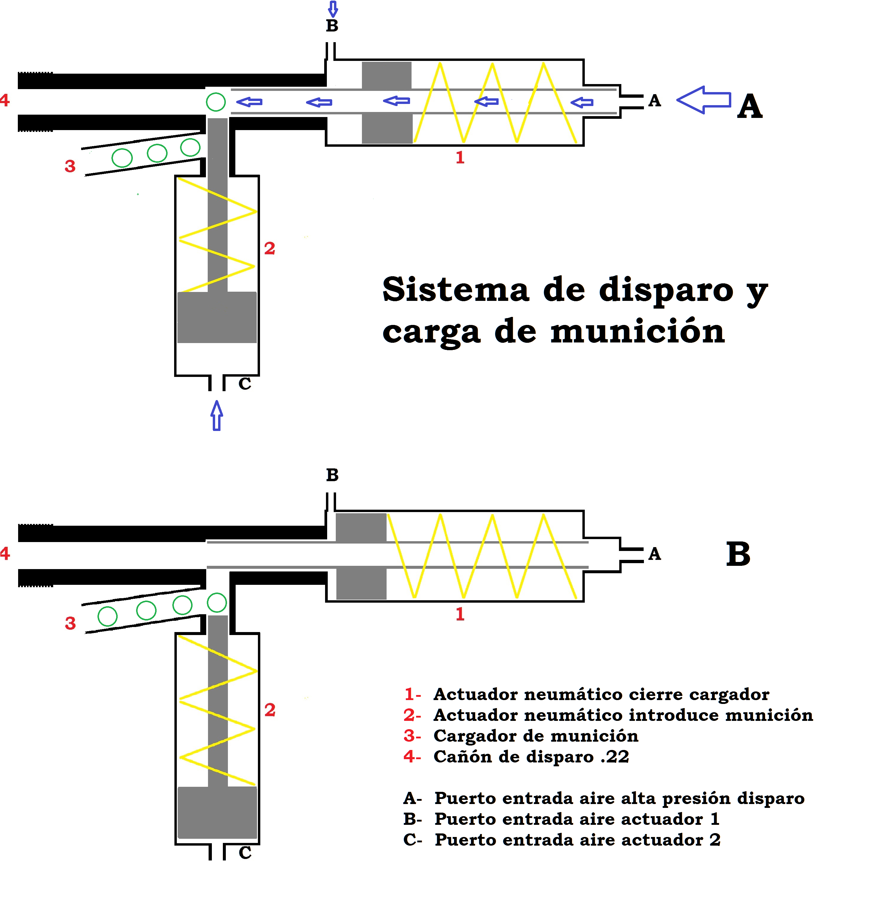

Sat Feb 10, 2018 9:04 am
My system is like that. Can shoot semi auto and full auto. :D
