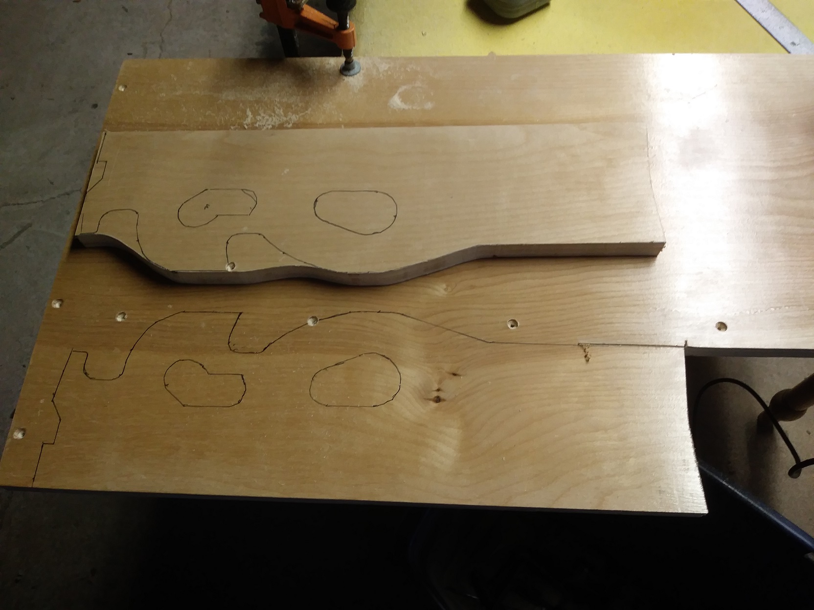

This may take some time to complete so I am going to take pictures of the progress. P90 style BB gun, maybe full auto or burst fire, depends how it works, or maybe not at all. :shock:
BB 2.jpg (23.91 KiB) Viewed 5996 times

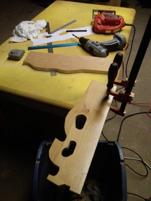

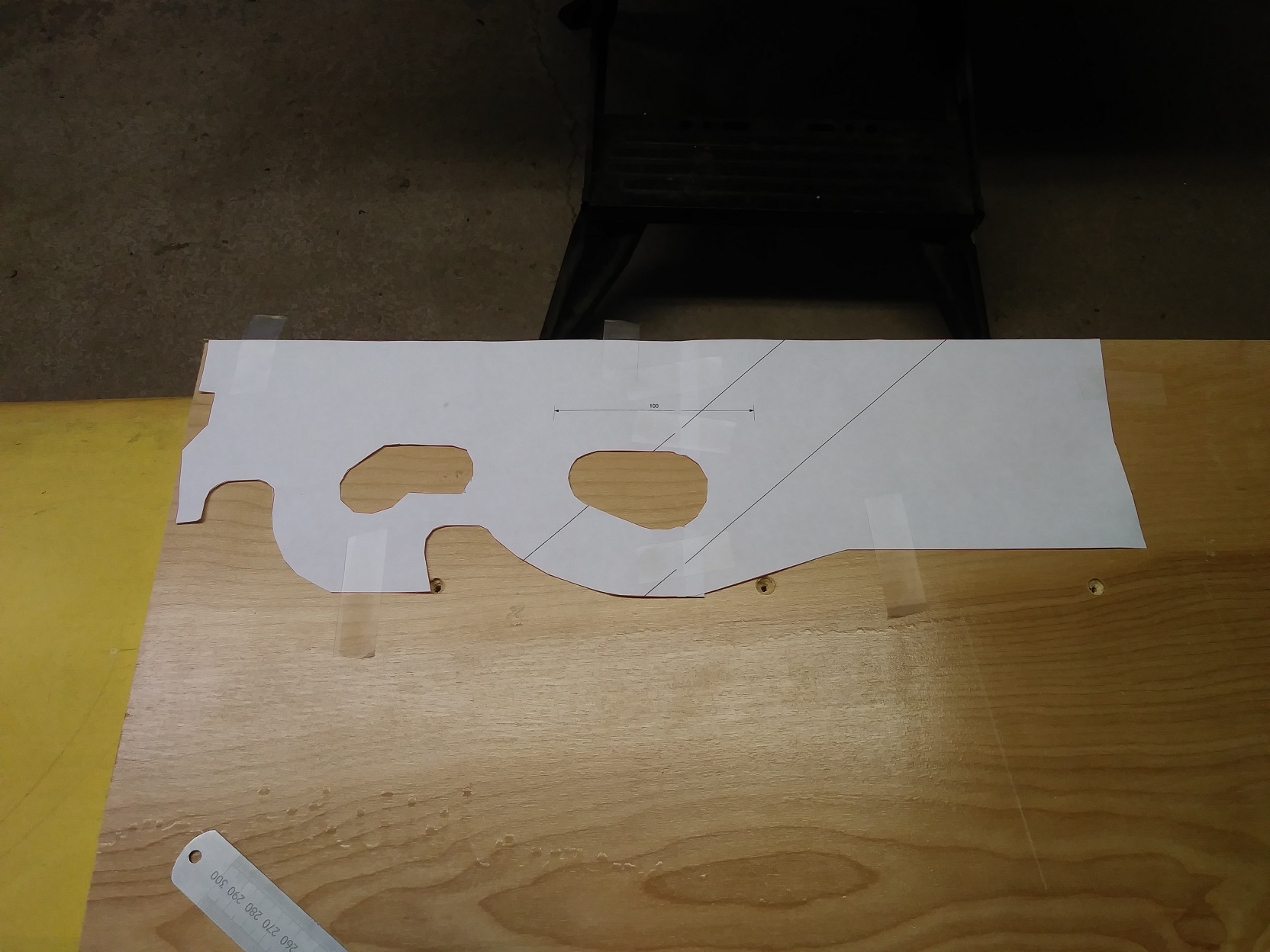

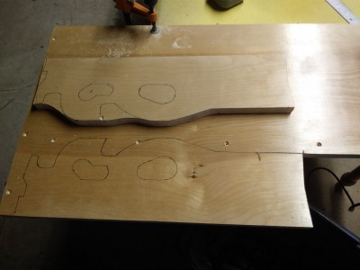

Cut out the rough body shape from 3/4" plywood. Will be in two halves screwed together.

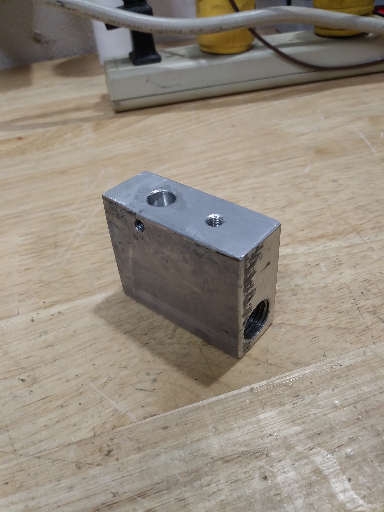

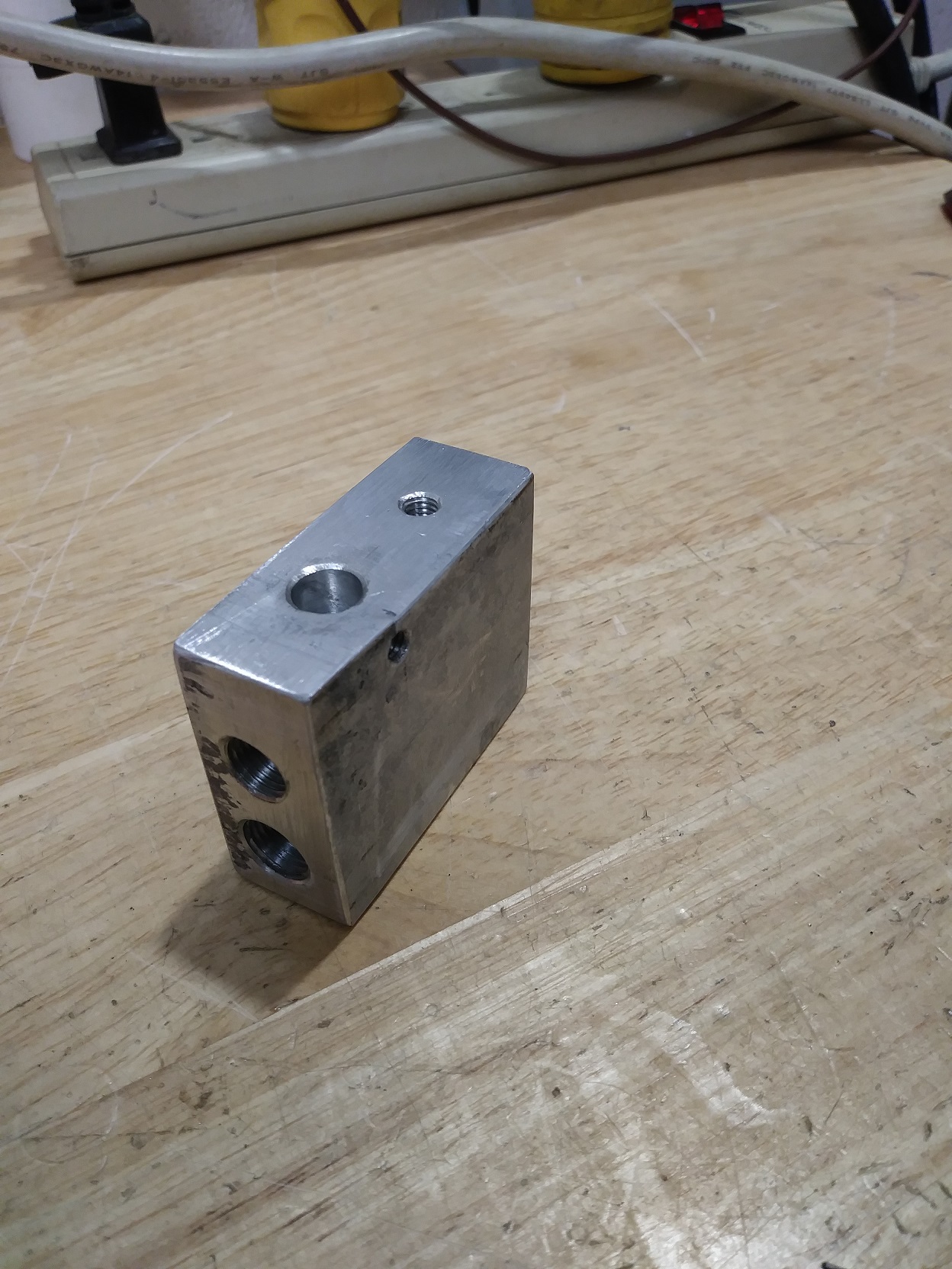

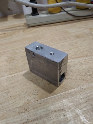

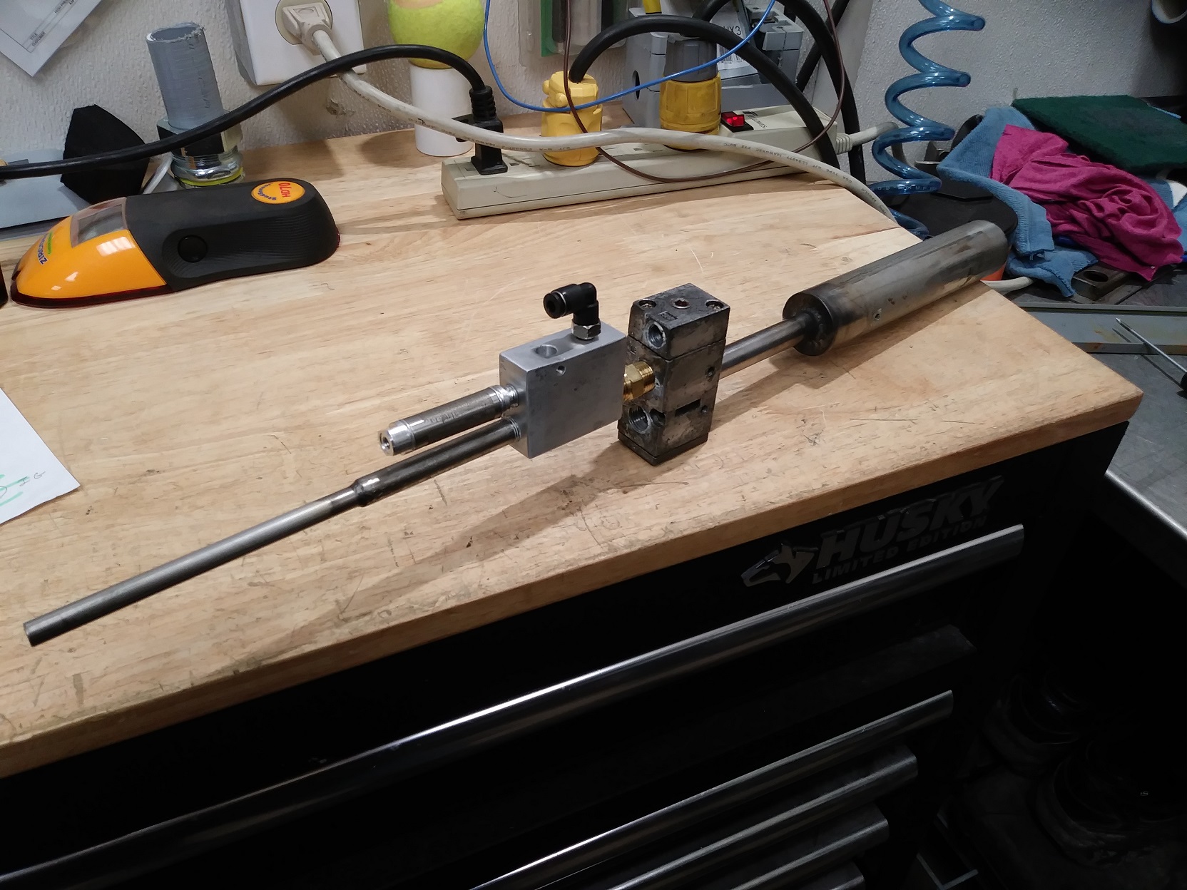

Been working on a block of aluminium I found, it houses a cylinder which will block the BB's when fired, it will be a 4 shot burst if it works :shock: 1" stainless steel chamber finished as well.

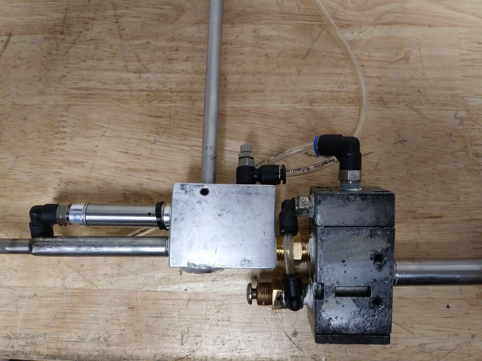

Thu Nov 22, 2018 4:45 pm

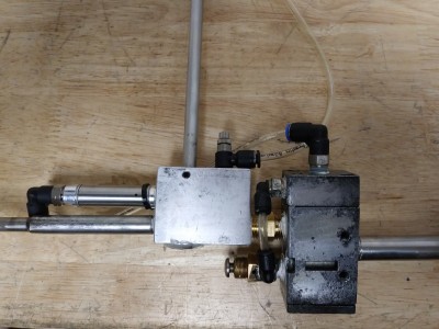

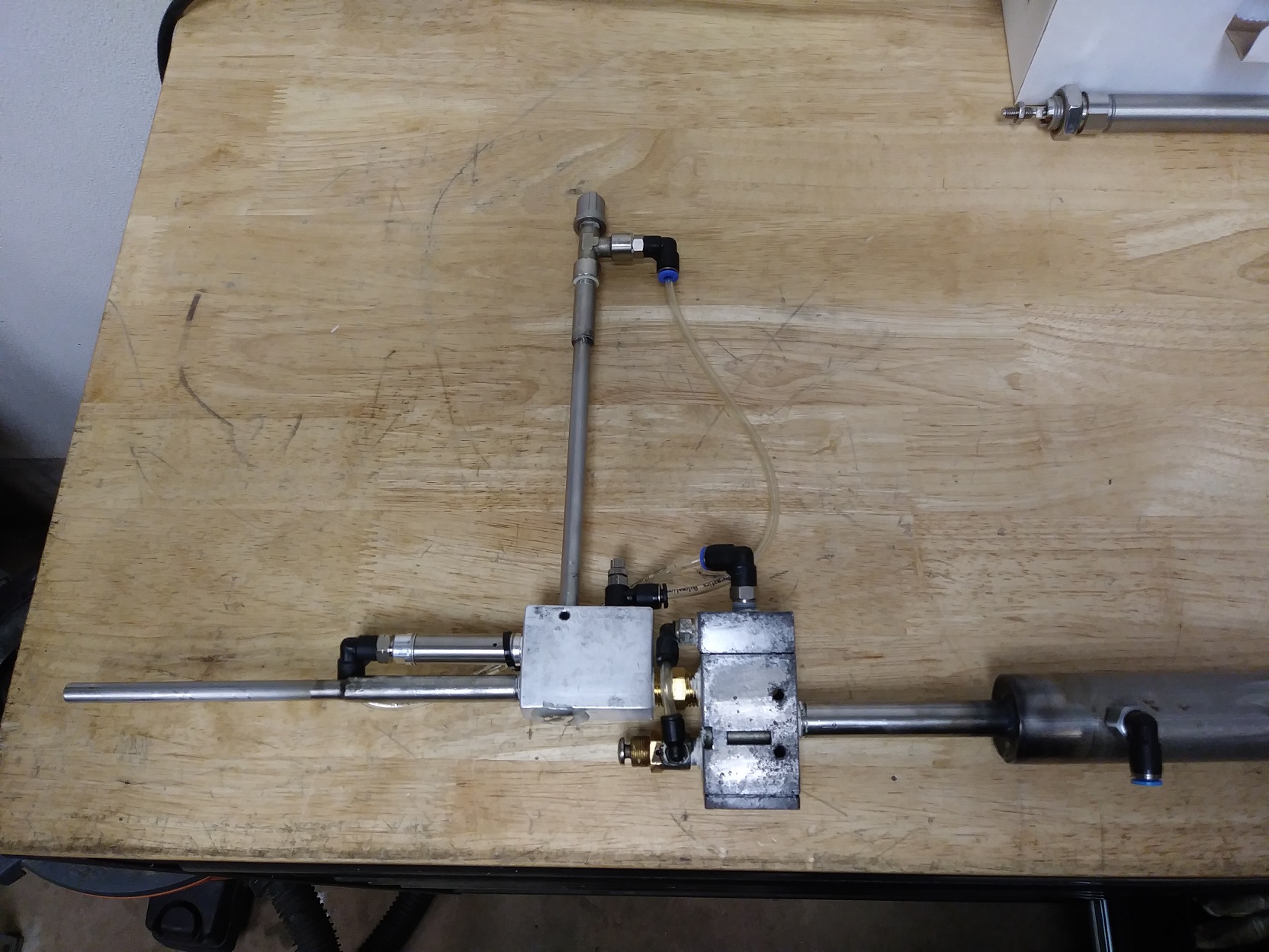

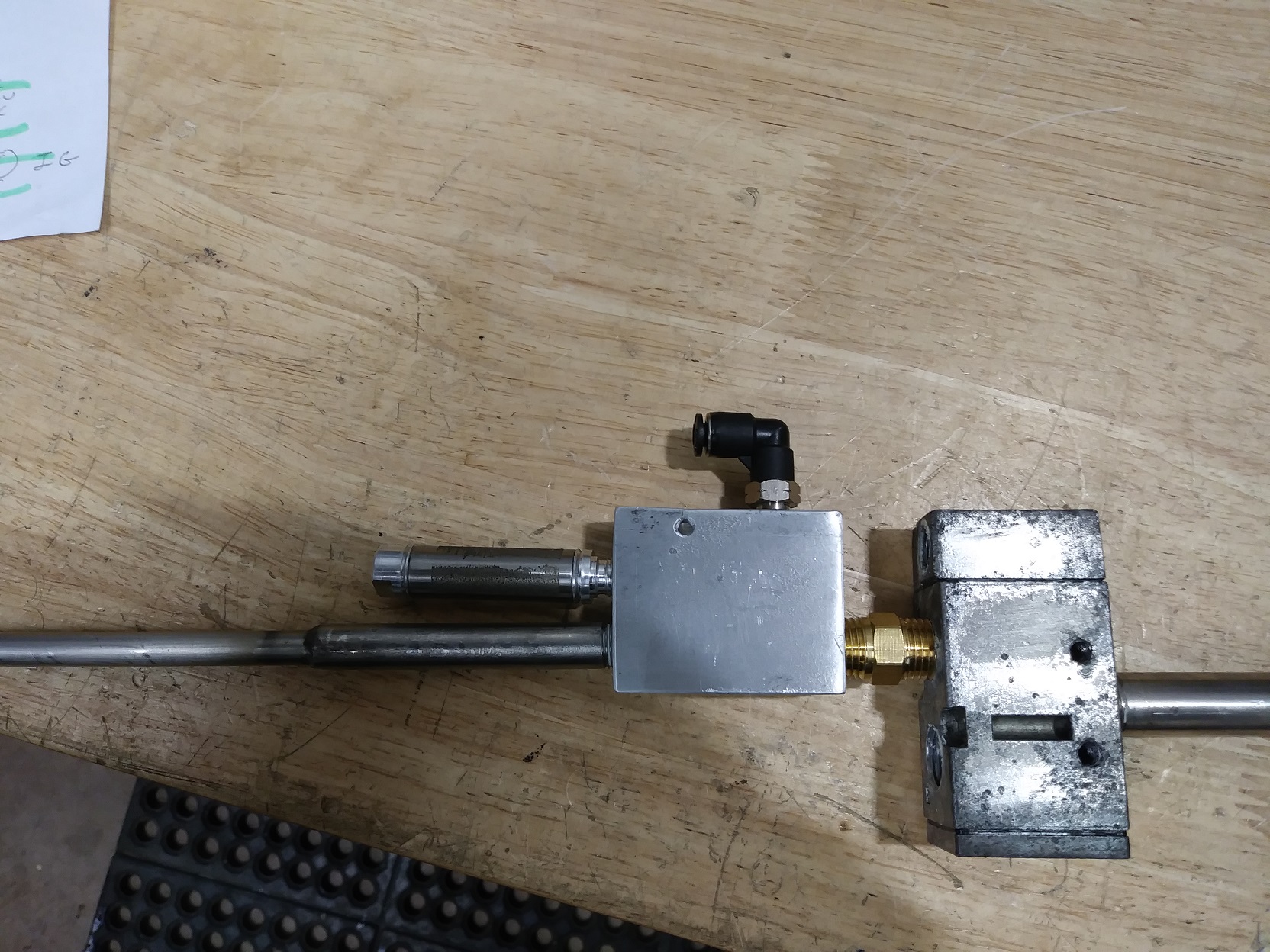

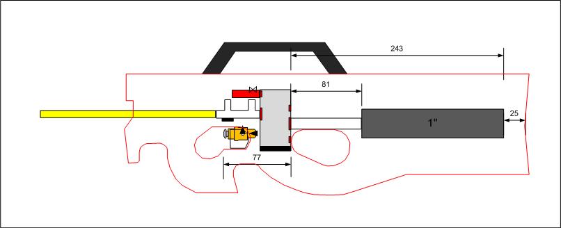

Had to change it a bit as I realized there wasn't enough pressure in the barrel to operate the blocking cylinder, had to move it to the pilot supply which stays at full pressure. Tried a gravity fed mag but that won't work unless it has some pressure on top to keep the BB's down when firing, finally got the burst fire to work :D

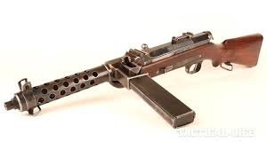

Looks like something I made a few years ago :shock:

How many shots per second do you think you can achieve? It looks compact, and will be excellent with wood placed. I like it.
In my automatic weapons, I use pressure in the magazine where the ammunition is housed. A small pressure of less than 1 bar is enough to put the ammunition in the firing tube, even against gravity. It is necessary that the ammunition have a little adjustment in the charger tube.
