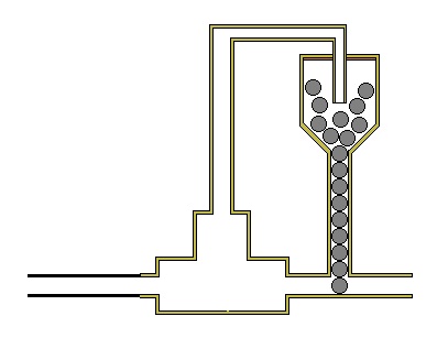

I drew this up while playing with paint, trying to get a rediculous fire rate not of interest to me to try but anyways, the idea was to blow and jams away as well as force loading the magazine from a hopper. Reading through these forums this may also be a use for the wasted air it the poppit-QEV guns where the poppit air is fed over the mag in the hopper. Use it to constantly shake up the hopper and feed the mag, air aint wasted its still going out the barrel.Duane31 wrote: People using these pop valves and what not, what are you guys using as reliable magazines? Gravity fed doesn't seem to work well enough from my experiance. Standard airsoft mags work with some modifications so they will shoot .177 (smaller diameter spring and BB journal size has to be changed).
I'm also interested in peoples ways of joining the mag with the barrel, your working with quite tight tolerances there and it isnt as easy as it seems at least without a lathe, cant just hack into it and preserve the .03mm (in my case) clearance while giving a smooth transition.
- pressuremag.jpg (17.39 KiB) Viewed 3989 times
With this sort of magazine, the BBs are automatically shaken by being pushed into the magazine after every shot.
You can see this in practice here with a clear hopper:
