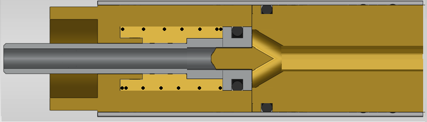

I reckon the whole circuit and batteries could be made to fit into the same space the AEG's battery fitted, even LiPos if it was uncased.
Or if you went for a mechanical solenoid control, even have the circuit in the gearbox, the batteries where the batteries went anyway.
There is a little bit of room for custom shaped bits...
http://kuba-t1000.com/minigun/obrazki/a ... x_view.jpg
If the was design use some form of pop off, any ideas for semi-auto selector ?

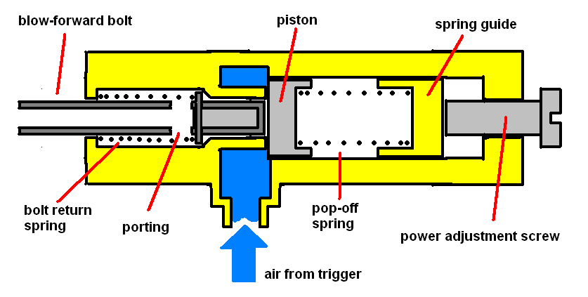

quick and dirty before I miss my ride home:
edit: here's roughly how I would build it, there's more than enough space to incorporate both the blow-forward valve and pop-off valve.  When I get a lathe/mill... you'll see...

Thanks for all coments.
when I started this project I was thinking about using QEV and pop-off... but it was too complicated. The second reason was the price.
In current project I was able to simplify desing.
I like upper jackssmirkingrevenge's "sin_ttulo_980.png" picture. That's great idea. There are some difficulties about making guide for piston - it needs good quality of turning/milling.
Currently I'm looking for a mini-solenoid which can be hidden in standard Gearbox. Electronics I can made using SMD parts, so it can be miniaturized and also hidden in a gearbox - but I have troubles with searching for a mini-solenoid.
In my opinion the best option is full-stock for M4/M16 and hidding a solenoid into that stock. LiPo battery can be hidden in front grip and that's the best option for now.
Do you mean in the front section holding the thin part of the piston ?
It can be removed, I believe it's purpose was to prevent the spring from being the bumper, but If that slightly larger diameter on the piston was made longer it would do the same job.
The piston is supported at two points that are relatively far apart (over 1.5 times the max diameter), so the bearing surfaces don't have to be very long.
Otherwise you could just make it from two parts.
I have certainly seen shorter 3/2 1/8" valves (I have some back at home can't remember the brand though), have you tried direct acting ones instead of pneumatically assisted ? They should be more compact as they don't require the extra 3 small pistons.
Making a valve would out of the question ? I guess by that point you might as well make JSR's pop-off design. (Mmm actually you could just modify your solenoid valve to be direct acting, you could cut it's size down considerably)

Kuba_T1000 wrote:when I started this project I was thinking about using QEV and pop-off... but it was too complicated. The second reason was the price.
In current project I was able to simplify design.
I don't think my design is terribly complex and anyone with reasonable lathe experience should be able to make it in sections - and you can't argue that completely eliminating the electronics doesn't make the project much simpler ;)
unfortunately direct acting ones have much lower flow and higher power consumption
However it is a great idea, IF you modify the design of the blow forward valve into a 3 way valve and use a small solenoid valve as the pilot. That could be a neat way to minimize the size as you can get really small valves that don't have threaded ports
