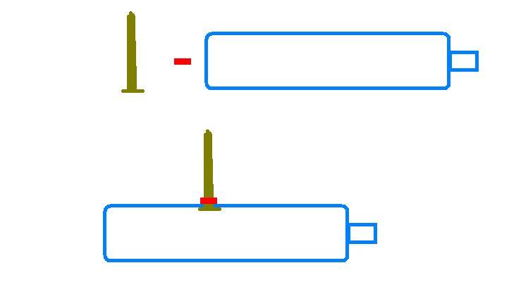

A compression fitting usually using a nut, just drop it in move it about till the stem comes out of the hole you made put on the nut and tighten it up real good. sometimes glue is used as well to make it airtight but a little bit of rubber does the trick nicely.
if you still are confused I can put up a diagram.

cammyd32
Great Britain
Posts: 326
Mon Oct 03, 2011 3:29 pm
OK the schrader is the sickly yellow colour blob, the nut is the red blob, and the coke bottle is the blue object (not to scale), you can see how tightening the nut real tight creates a good compression fitting. :D

Mon Oct 03, 2011 3:36 pm
I just drill a hole in the end of the coke bottle, smaller than the tyre valve with rubber around it, then just push the valve in the hole, for the pressure I was using (about 20 psi :lol: ) no leaks
Pedrojoca
Posts: 13
Joined: Fri Jul 08, 2011 5:18 am
damn, my schrader valve can't be attached to a nut :P
cammyd32
Great Britain
Posts: 326
Mon Oct 03, 2011 3:37 pm
Then good old epoxy is probably your best bet :D
