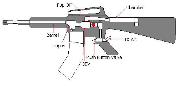

Why dont you build it into an airsoft gun body like your P90? You can use a m16 body and use m16 magazines, but cut the handle to accapt a 1/8 inch push button valve instead of a pressure washer handle and ya. here's a pic to explain a little better...
QEV pop off in M16.JPG (26.39 KiB) Viewed 7199 times
