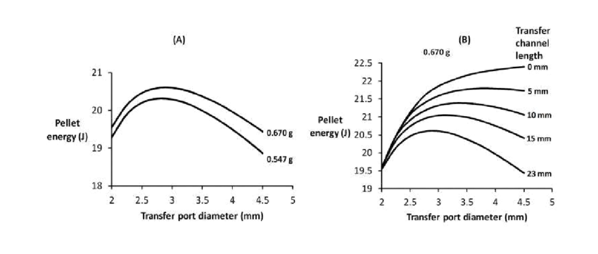

Thu Jun 29, 2023 7:15 pm
Ok, this data was from a springer.
Found on internet .
Transfer ports .
Dunno if adds anything .
But here it is .
Effect-of-transfer-port-diameter-on-pellet-energy-for-two-JSB-pellets-figure-on-the-left.png
Fri Jun 30, 2023 9:46 am
That is from this study of springer ballistics which is an interesting read, but not really applicable to pneumatics because in a springer it is affecting compression ratio so transfer port volume is critical, more so than flow.
