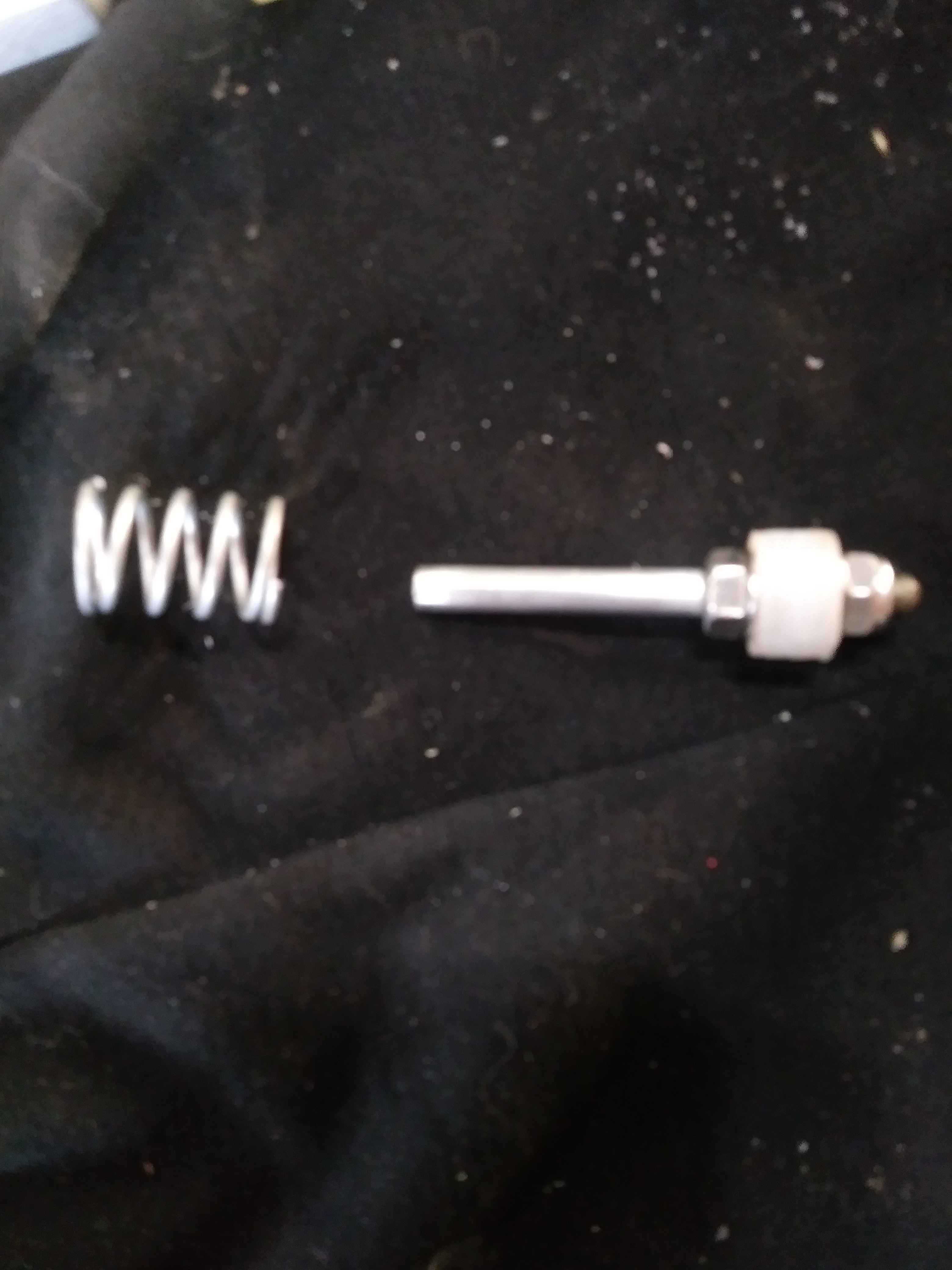

Made new piston from long 6mm bolt with head cut off and piece of 10mm thick nylon, works really good. Semi auto is now built in to my old single shot.
